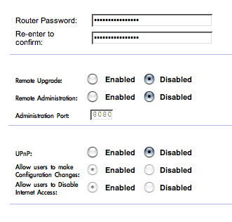

Using a different browser I was able to get to it . This is screen shot of the only section that has anything to do with port numbers
can i see the main config screen, with the whole screen being shown? that would help.
