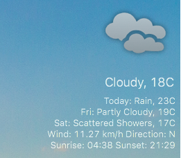

Thanks for all your great help here guys. The XML is stored using the following command
set weatherCurl to (do shell script "curl --silent 'https://query.yahooapis.com/v1/publ...ecast WHERE woeid= 22961 and u="c"&format=xml' | grep 'yweather:' >" & weatherFile2)
Obviously weatherCurl and weatherFile2 are defined elsewhere. weatherFile2 is a XML file but there is not any carriage returns anywhere. Not sure why.
I am not much of a coder I must admit and have used the following crap code to force a carriage return
do shell script "tr '<' '
' < " & weatherFile2 & "> " & weatherFile
This seems to work my original Yahoo script and now I get the attached on my desktop. So its working albeit with my crude code.
