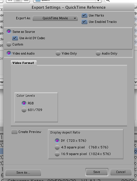

You can make a QT Reference using Avid, which is a small file, as it points to the Avid media in Avid MediaFiles and Omfi MediaFiles folders.
With that you can also work.
What I do normally is make a QT Reference, using the Avid DV codec and proper settings like progressive and the right aspect ratio and frame rate.
Then I use MPEG Streamclip to convert it something I can use in the other application I want to use, if this application fails to read the QT Reference or if it goes to a system without Avid.

Then it would be best to export the sequence with one frame rate (the one the smaller and older Panasonic DV camcorder will record with) and one field format, either interlaced or progressive.
You can make interlaced footage progressive (at least from a technical point of view, it won't look like real progressive footage) in Avid. Have a look at the Help section.
You can use the following settings to export with good quality:
Either
or DV Stream
Maybe ignore the "Preserve aspect ratio" checkbook and try it without.
