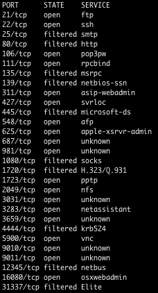

However I can only access my server via the "Server Admin" package on my server. If I try to connect from an other Computer (my Laptop) with any account (including root) I get the message that I wasn't abel to connect to my server!?
Also if I enable Web Server I can access my site at http://localhost/ (aka: the server works) but I cant access this from an other computer!?
If I nmap my server from an other Computer I can see that port 80 is up! (but it's filtered!?).
And afp doesn't seem to work at all!
A fair number of the features of OS X Server are heavily dependent on your server having a fully-qualified domain name, and if you're using dyndns, you don't have this. You can get around this by using a local-only IP address and setting it up a DNS server on the Mac.
Next, your issues sound like firewall issues, and it's possible to get ipfw to show you every packet that's blocked. I'd start there.
