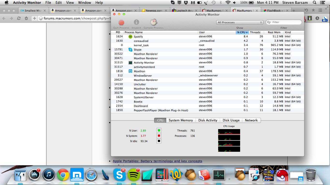

I probably should of stated this before. I did some makeshift tests of my own, and by leaving my computer with nothing but Skype open (CPU running at less than 10%), and with brightness halfway, I got 2 and 1/2 hours of battery life. That is my max. My battery also drains quickly while asleep. About 10% or more if I leave it closed for 12 hours. This is what I usually have running on my computer.
Nothing you can do but isolate the problem that causes your battery drain. My 11" 2012 MBA is at 274 cycles and 93% health and I can get about 4-6 hours depending on use. As soon as I pull up something flash related that 4-6 hours drops to 1-2.
I installed Flashblock into my browser, and I will see how it fares now, as normally I have my browser open at all times. Thanks for the input!
