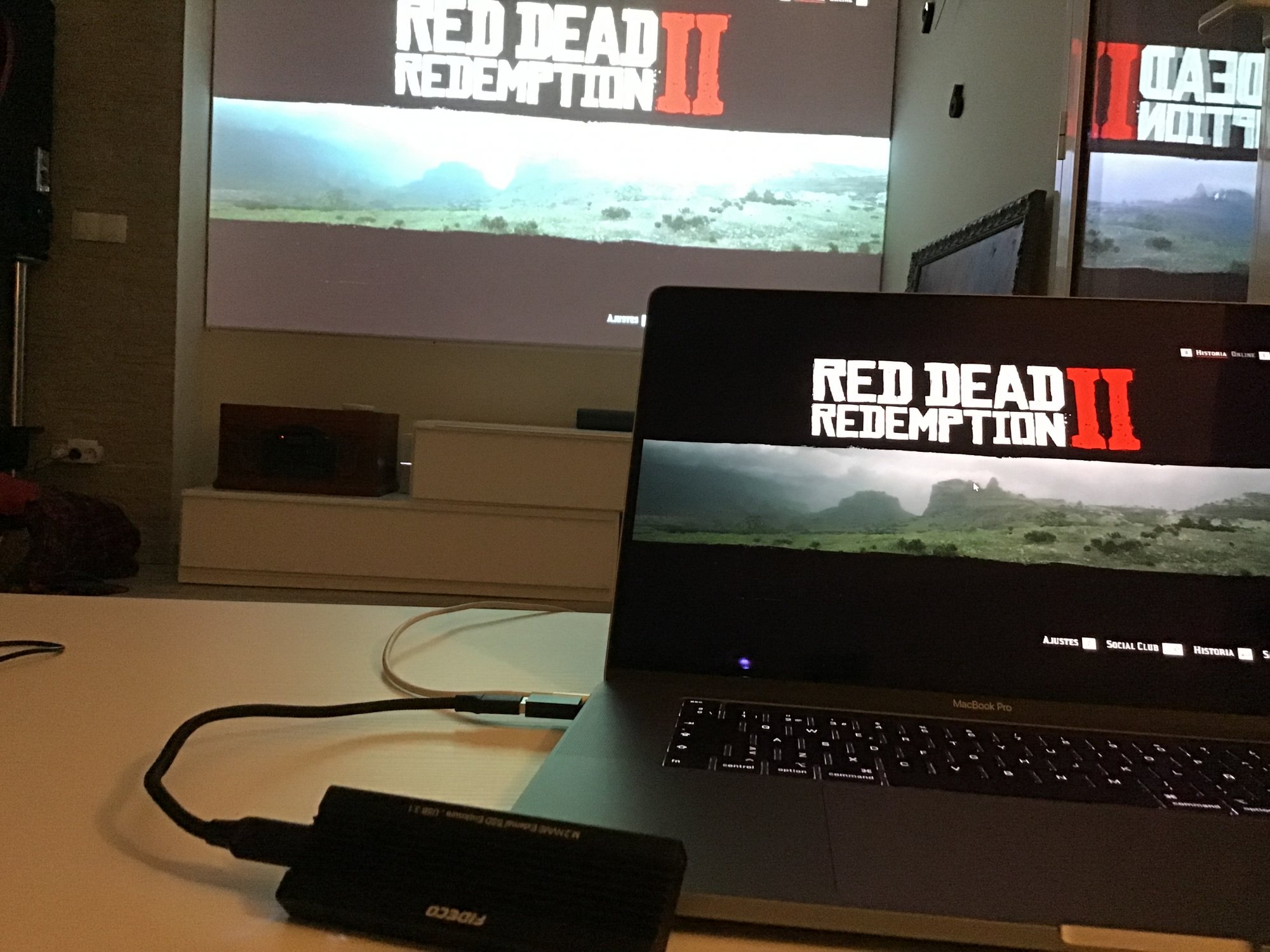

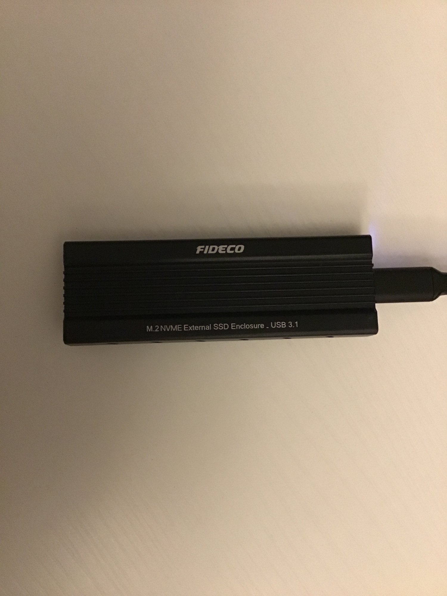

Hi, I was trying lot of methods without success. Finally I returned the X5 drive and got a Samsung 970 Evo Plus 1 TB and also a external USB 3.1 enclosure. With that I installed Windows at the first attempt (rufus, Windows To Go) , I have until 1GB/s what is really fast, not like X5 but more than enough for run after effects and play games like RDR2, all in the external. Now I have the 1 TB of the MBP and another (external) TB for when I want Windows.
It is what I wanted.
