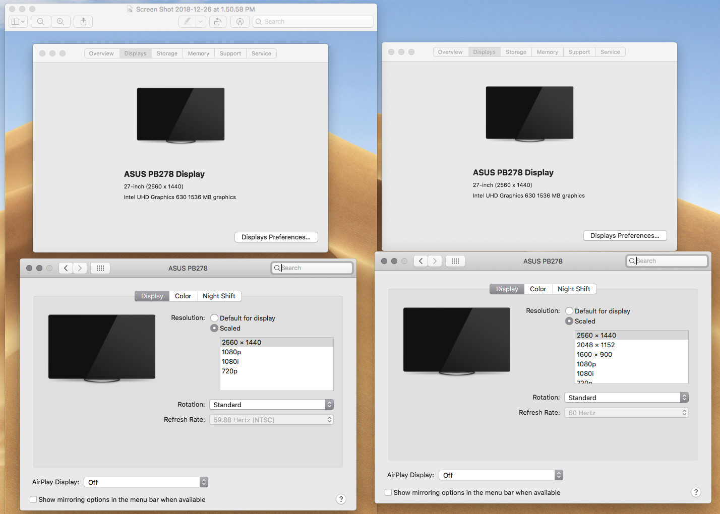

Here is a USB-C to displayport connection on the left from yesterday, and the HDMI connection I just made today with my new cable on the right. Everything is the same, the end result is the same.
If my monitor stops working then I will research it further, but it won't because hundreds of thousands of people use this type of connection, while it's only you telling me to buy a $36 cable because "it's certified and I say it's better.
There is a small difference, look at the refresh rate. I doubt that will make any practical difference. I suppose the presumption when using HDMI is you are connecting to a TV.
