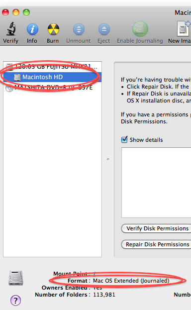

I'm not 100% sure about this, but it may be due to how your external HD is formatted.
Certain formats (FAT32) only allow a single file transfer to the drive to be less than 4GBs. So, if you're uploading a movie from FCE, it creates a single file, once that file reaches 4GB, the HD will not be able to transfer anymore.
Here's how to check. Open up the app named DISK UTILITY. Then on the sidebar, select your external HD and then check the format. I put a picture up to show an example but be sure to select your external as I selected my Macintosh HD.
That's my guess. I could be wrong.
If that is the case, than this is the painful solution: you need to move everything off your external HD on your MacBook (as everything on the external will be deleted). Then, through Disk Utility, reformat your external HD to Mac OS Extended (Journaled). Then move everything back from the MacBook to the external HD.
In that format, you can transfer a single file as large as the drive itself if you wanted. However, I think Windows computers can't read that external HD unless you download a special program on the Windows machine (FYI).
