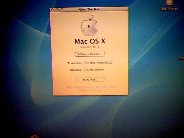

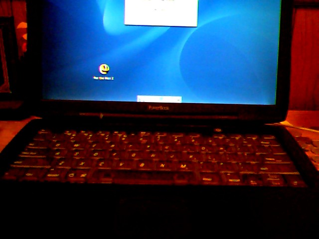

i took some crappy pictures of it with my web cam. the "about this mac"
says
Mac OS X
version 10.3
processor 500 MHz PowerPC G3
Memory 256 MB SDRAM
The cd drive doesn't work and i was told that the hardware is fine but the program that runs it was deleted.

Pictures are not the best, but it looks like a possible "Pismo".
http://www.halfvalue.com/identify-applepowerbook.htm
Either way, given the speed and specs it would have the necessary hardware built-in for the DVD drive.
