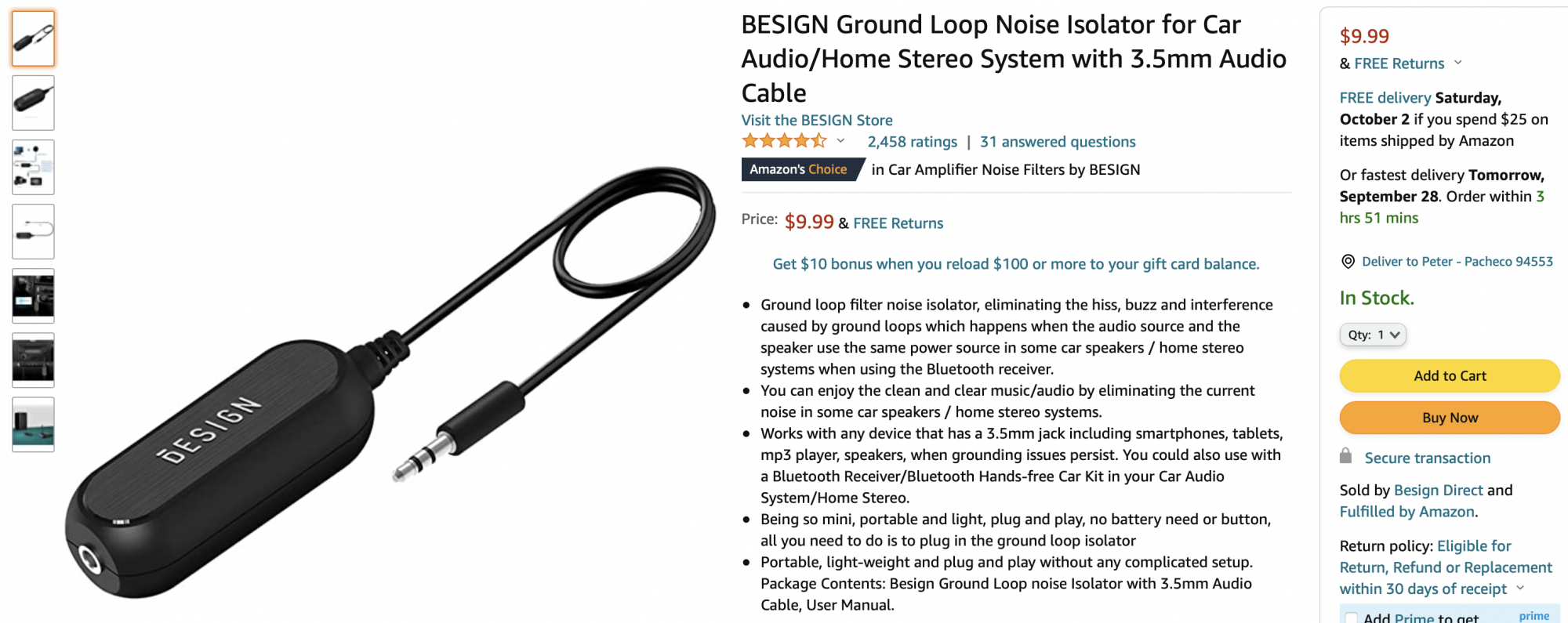

Had the same problem when I used the line out to my home theater system. Amazon sells a isolation gizmo for less than $10, will solve your problems.
