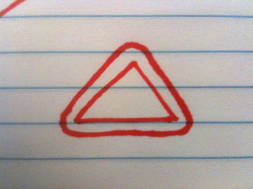

I had to re-read his post several times to figure out what he was talking about, but... I think he meant this.
Rounded tips on the outside, with a normal triangle on the inside. Strange, I know.
