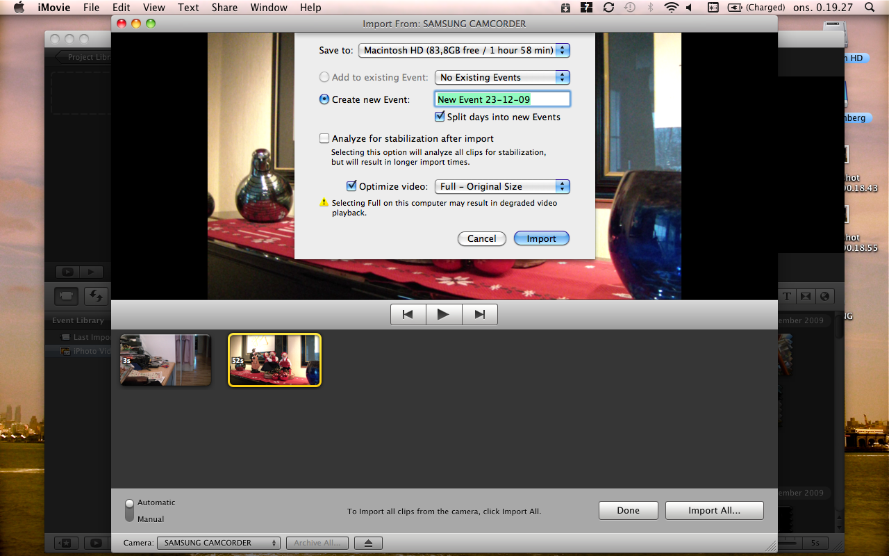

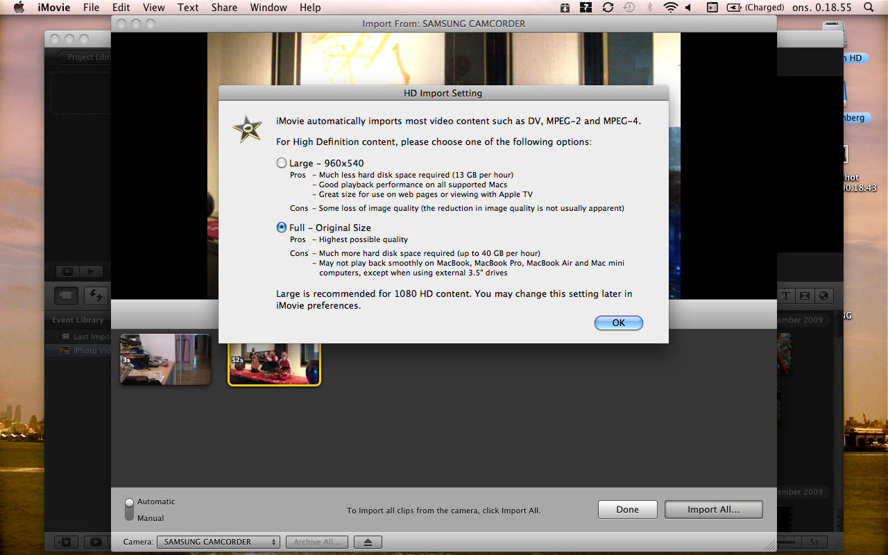

Import:
Connect camera
Import automatically from iMovie in full quality (attachment)
Make a project. Usually I dont even edit, just copy it all.
Share: Export Movie. There I save in widescreen. And it starts to export.

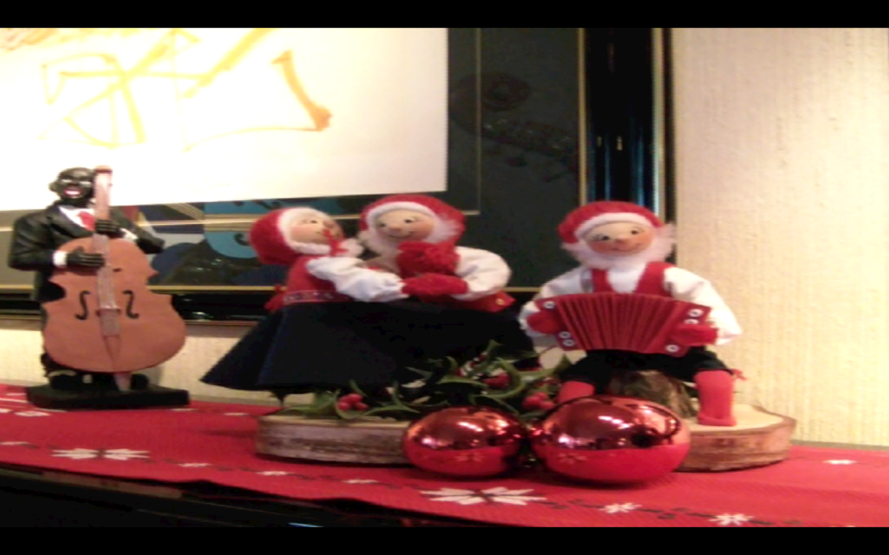

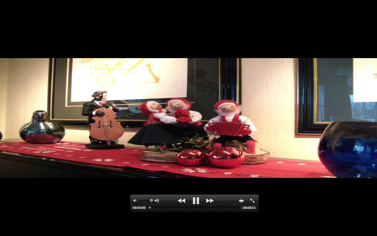

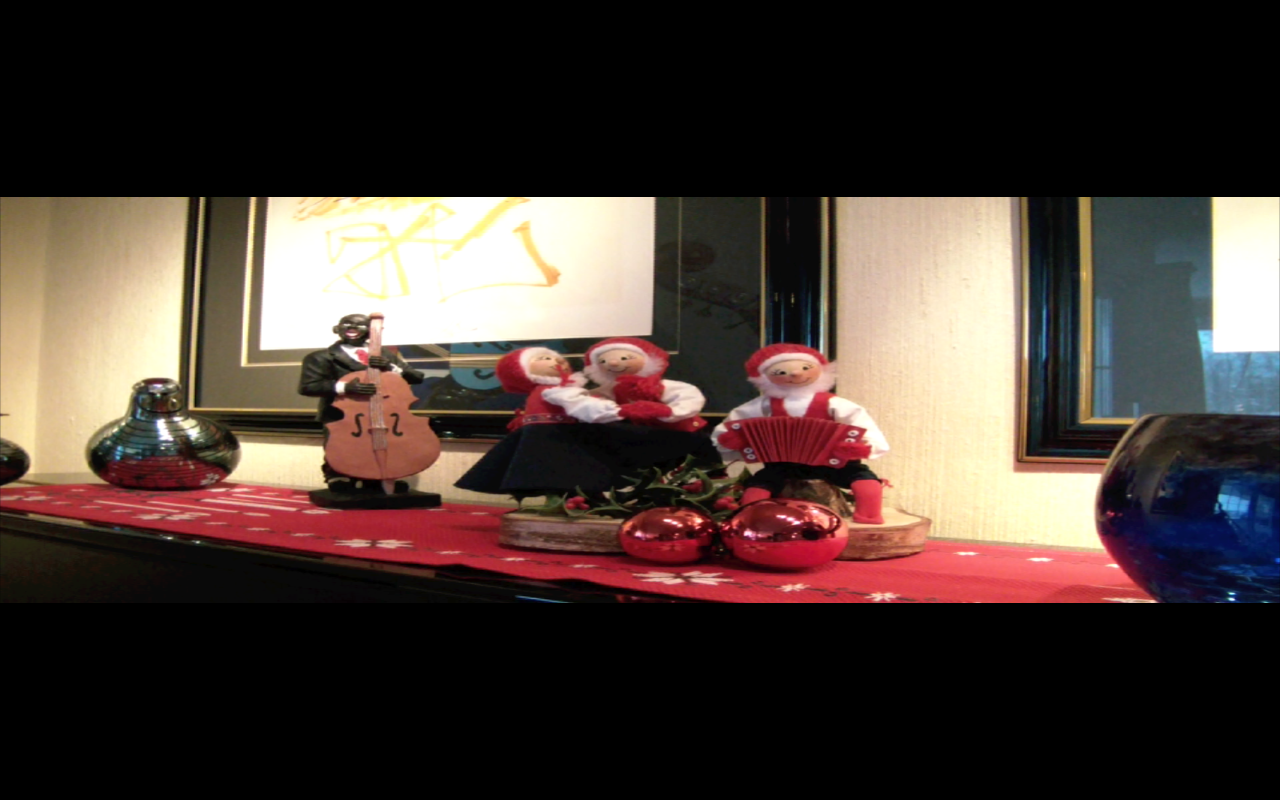

PS: The photos I've added, I dont know if you can see any difference, because this is screen shots from before i burn the movie. I didnt bring my super drive with me so cant make a DVD now.

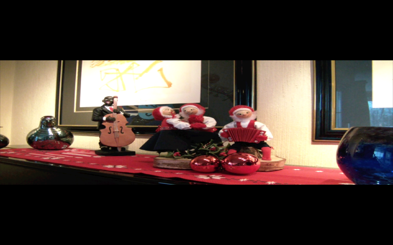

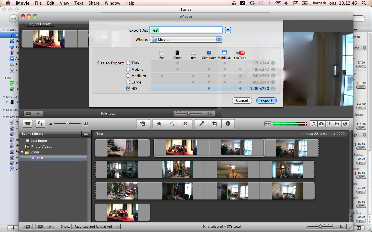

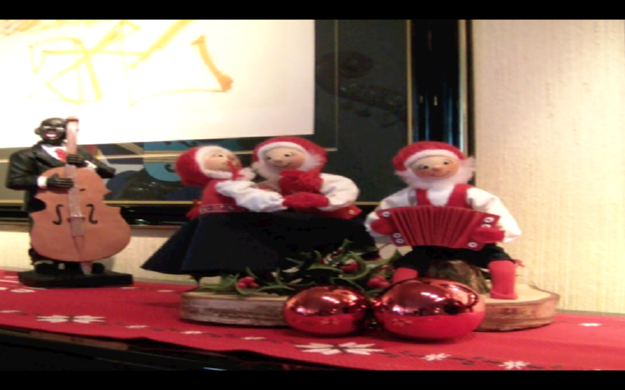

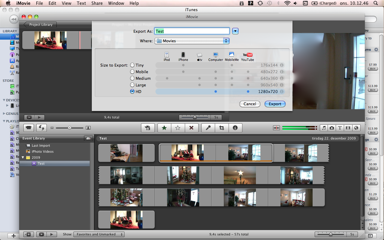

I realised that I didnt export the movie so you probably cant see a difference in the photo. But I've exported it and taken a screen shot. I also took a screen shot of the settings I use before I export 🙂
Dimensions: 1280x720
Codec: H.264 AAC
