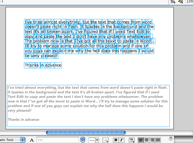

Ok, I got it to happen on my TiPB!!
Ok, here's what I did. I copied and pasted you post into a new word document, then selected it all and tried to paste it into new flash document. I got exactly what you said you got (see image).
So to fix this I saved the word document as a text only file, and opened it with IE, selected all the text and pasted that into flash and it worked fine, bottom text in image. The only thing I did was add line returns to wrap the text.
I think what's happening is the Word is trying to keep the format it sees on the page and messes it up. So try this and see if you can't get it to work.

One other thing I tried that didn't work was grouping the text and then trying to edit it. Very strange, but like I said, it seems as though MSWord likes to keep the format you see on the screen, so you're pretty much forced to take the long way.
D
Sorry for my late reply but I wasn't able to come to the forums. Thanks for your help guys! Dukestreet thank you very much for the help and for the picture with the example! Going to do things just like you said it! Thanks again!
