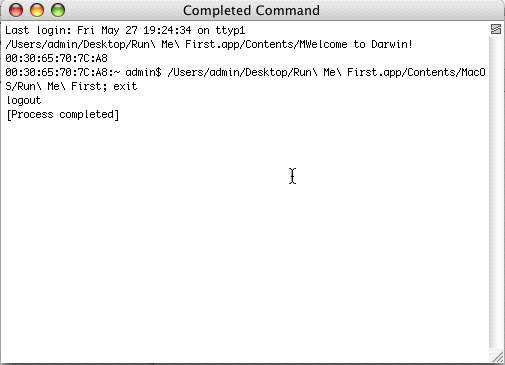

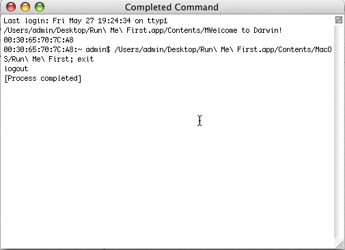

I now ran Run me first in terminal on a fresh installation of tiger(fully updated).
All it said was "logout [Process finished]" so I guess that worked(I attached a screenshot below).
After I installed my rage 128 and ran the dumper it actually dump the rom.
But the flasher still doesn't do anything, even though I installed the rom from my rage that I dumped to it.
And I still can't get it to dump the rom of my Radeon 9000 which leads me to wonder, if that has anything to do with this Mac lockout switch I read about(small resistor on the board, not unlike the once that determine the G4s clock speed) or if my card has actually died.
If it would proof to be that ominous lockout switch, how do I determine which resistor I need to relocate? There are around 26 of these 0 ohm resistors on the board(some of them below the heatsink) and I really don't wanna go threw each and everyone of them and resolder them just to possible find out that my card might just be dead. And the to pictures online that showed this resistor showed other pcbs than mine(there is a guide about that on Mac elite and a forum post on OS9lives although I think that one was about the 9200).
