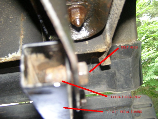

Long story short I have a bolt that I need to undo on my car. It has no nut but the sheet metal has a punch or w/e in it to make the bolt interlock with it. No matter how much I wrench it won't turn, probably because the threads are stripped because the stupid dealer over tightened the bolts. I should also mention the other side of the bolt isn't really accessible.
Other than a saw, which will be somewhat hard to use because of lack of space, does anyone know how I can get this damn thing off.

Ok I though this picture might help describe my situation.
The bolts (its actually 2) does turn, it just makes no progress. They are 13mm BTW.
Basically i am taking of these stupid running boards on my car. I wish this was like the other side of the car where they just easily came off. On the front end of the car it has the same setup as the picture for the most part. The bolts on the front were on so tight that I broke them off trying to remove them. Whatever works though 😎

The piece inside is turning with the bolt. It looks like it might be supposed to be attached to the metal tubing but broke off. I cannot get it to turn independently from the bolt. Its perfectly smooth all around so there isn't much to grab onto.

I am trying your method and i think it has helped a little bit. I have rammed a crowbar in-between the mounting bracket and the metal tube. My arms are so tired though, i have been working on this for literally like 4 hours.
