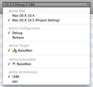

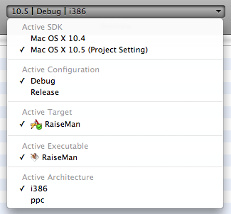

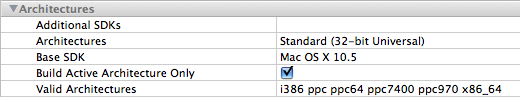

• Check your project settings to make sure they're correct for your processor type and target OS:
