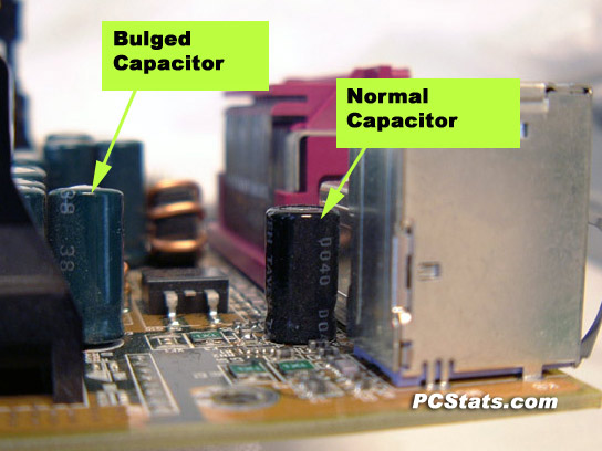

on a iMac g5 with G5 processor (not the intel in the same housing) i would before i do anything just open it up and look inside for the bad caps as they are in most cases the cause of GPU and other problems
it doesnt look like a screen problem as the known screen problem they get are only stripes on screen yours looks very much like a GPU problem
so look for capacitors that are bulging or leaking as thats the most common problem of the iMac g5
replacing the bad caps is easy if you know how to solder , if not the local radio repair guy might help , here in the uk ebay is full now with repair offers for the bad caps in G5 iMac's
here a pic how you can tell if caps are bulged or healthy on a bulged one the top is dome shaped not flat or the whole body looks a bit blown up , leaking is easy to spot too some brownish colored residue on top
