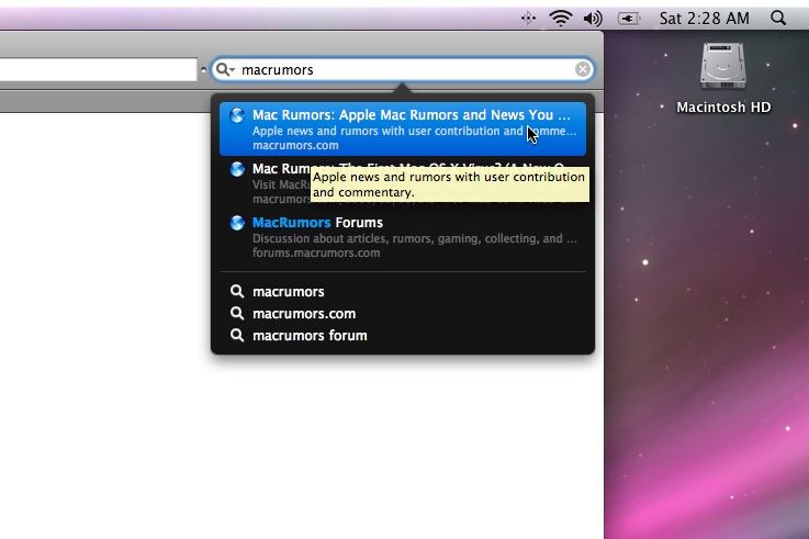

Success with Inquisitor!
HOWEVER... you MUST modify the Install yourself.
1. Run Inquisitor Install.
2. MOVE the Inquisitor bundle folder out of your user's ~/Library/InputManagers folder and into the /Library/InputManagers folder.
3. Run the chown command again from terminal to reset file ownership.
As far as Saft, the author builds in version control so the current B6 for Safari 3.0.3 will not work anyway in Leopard.

Inquisitor now works for me after installing the latest SIMBL, and Inquisitor 3.0 v 49. Installing the latest SIMBL also has re-enabled SafariStand.
It worked for me before installing that neat app that psychofreak linked to.
PlugSuit hasn't enabled Forget-Me-Not, unfortunately.
Inquisitor's author also updated the installer to meet Leopard requirements. I have tested a number of InputManager bundles using the manual move + reset ownership methods and all seem to function so far. That's good news for the Safari 3.0.x campatible plugins over at PimpMySafari. Now we just need a new version of Saft........
