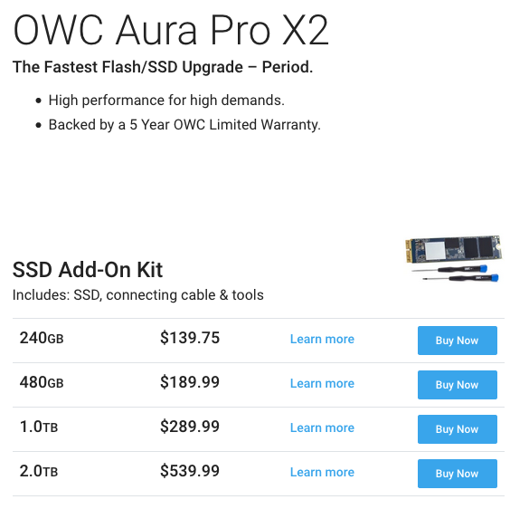

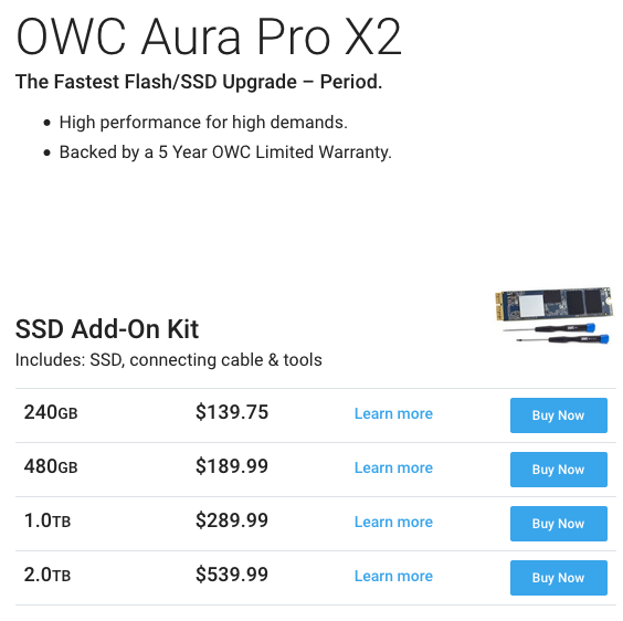

You might give OWC a call and verify that their OWC Aura SSD Add-On Kits include everything you need to install an SSD in a 2014 Mini that currently only has an HDD.
Reactions: QuietGamer
Thanks to the post above.
The adapter looks like the one you have.
There are links to the blade drive that works with them there, too.
For an alternative solution that uses a standard M.2 PCie NVMe SSD...
