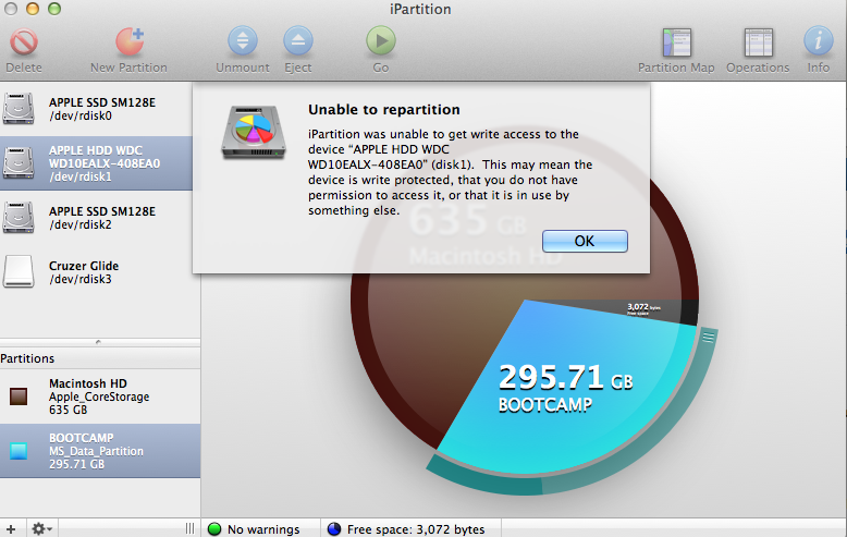

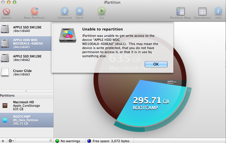

However, When I attempted to run iPartition from it, it gave me the error "Partition was unable to get write access to the device “APPLE HDD WDC WD10EALX-408EA0” (disk1). This may mean the device is write protected, that you do not have permission to access it, or that it is in use by something else."

Is the Disk encrypted with filevault 2, if so switch it off first and retry.
Edit: I looked at the screenshot, do you have Fusion drive, if so that might be the problem.

Is the fusion drive fused, is it shown as one disk in Disk Utility, if so than you can't partition the drive, reason it's not one disk but two, you can only do so with Disk Utility AFAIK or the difficult way with terminal.
Yes, it is fused. I was just trying to resize the main partition smaller and make the Bootcamp partition bigger.
If iPartition is not updated and I doubt they have support for fused drives it's worthless, you can't use it, contact them and ask them, if it's not supported try to ask back your money.

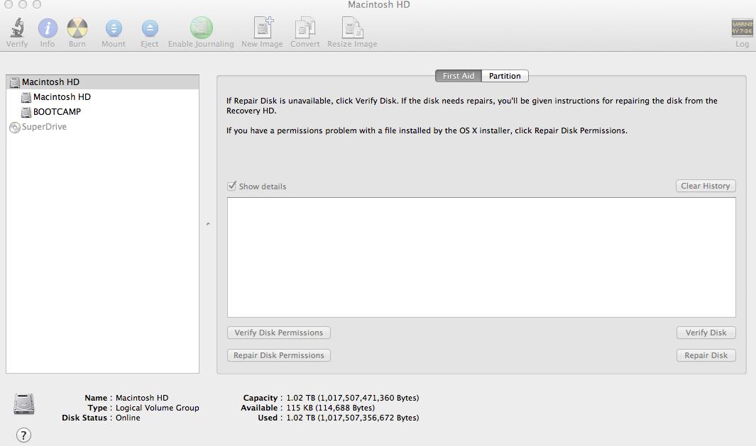

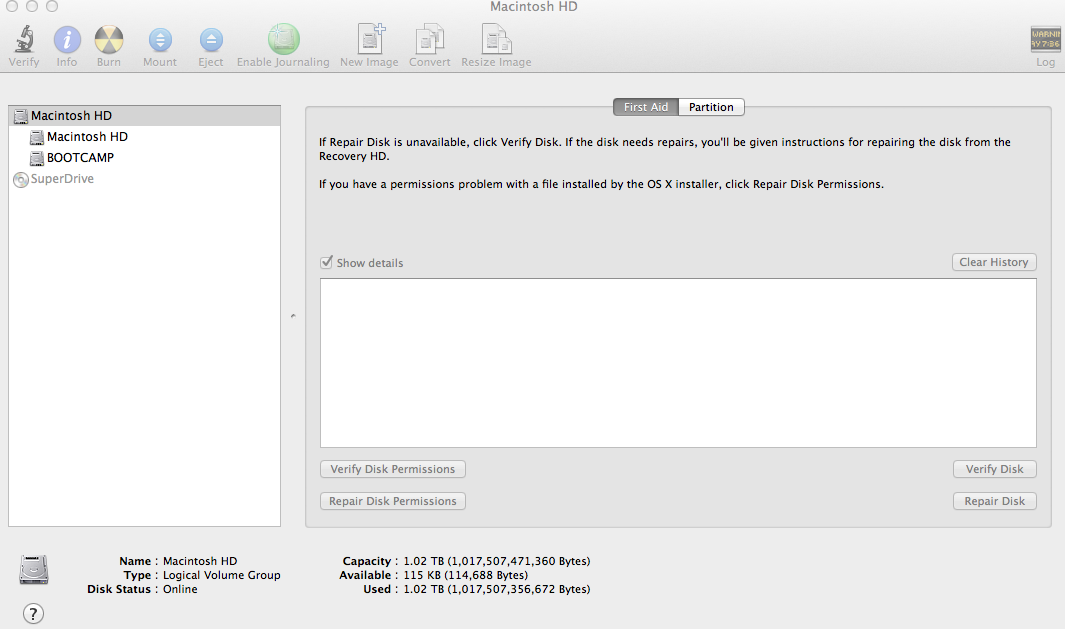

Here's a screenshot of my disk utility. I have e-mailed the customer support to ask for a refund for iPartition, because It's probably true that it's not compatible with Fusion drives.

Yes, in this screenshot it is clear it is fused, it says Logical Volume Group and online in the lower part.
In one of your posts I also saw Core Storage and this also points to fusion, not sure though if that is 100% true though.

Odd though it is not 1.128 TB
