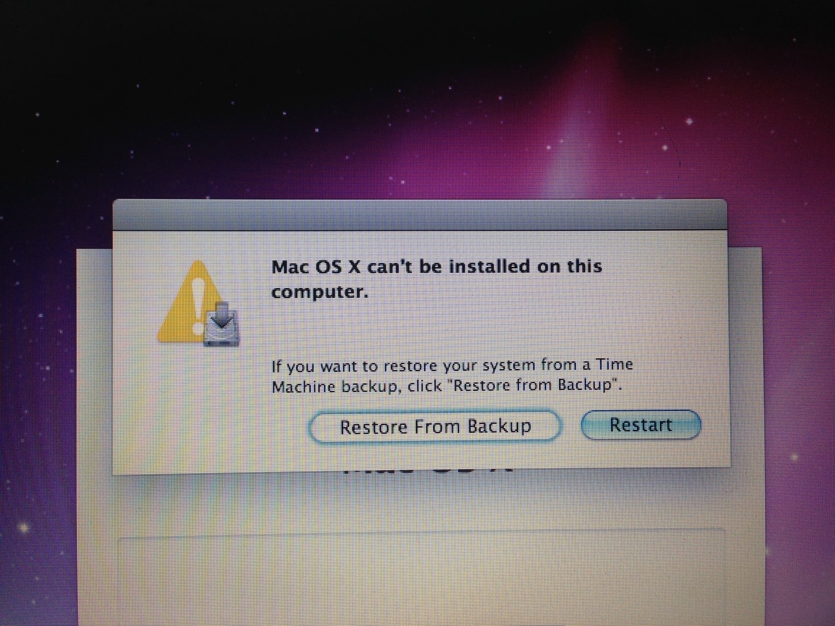

Hello all, I bought a MacBook model A1181, but the hard drive was wiped clean. I checked to make sure the hard drive and ram were still installed, and they are.
When I turn the MacBook on, I hear it chime and then it just shows a white screen. I purchased a MacBook recovery disk set, snow leopard, and tried to install it. When the install screen pops up, I click English, but as I do that a little screen pops up and says "cannot be installed on this computer"???? I went in to disk utility and erased the hard drive and created a new partition, but this has not helped. Any advice is greatly appreciated. If you would like screen shots I can take pictures to help clarify the issue. Thank you in advance.

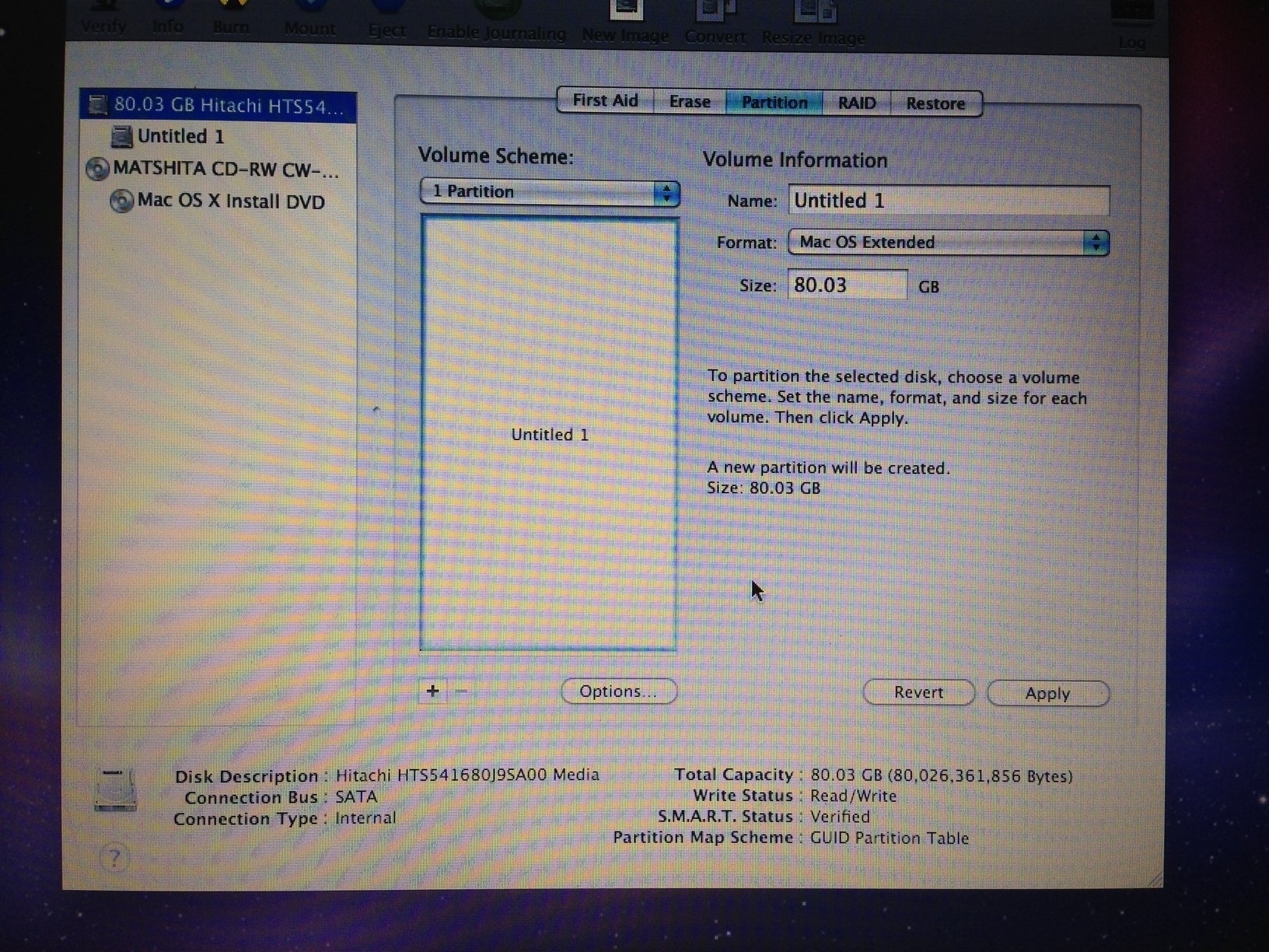

Boot from the snow leopard disc. Open up disk utility from the top menubar. Click partition, select 1 partition, then make sure the disk format is set to Mac OS Extended format before clicking apply. Exit disk utility and start the Snow Leopard installation. If that doesn't work then the hard drive is likely to have died and will need replacing.

Ok, when you partition the disc, select 1 partition and make sure you've selected mac os extended format as I said before, but this time click the options button just below the white box showing the partitions and click on GUID Partition scheme. click apply, exit disk utility and run the snow leopard installer. This should fix your problem.

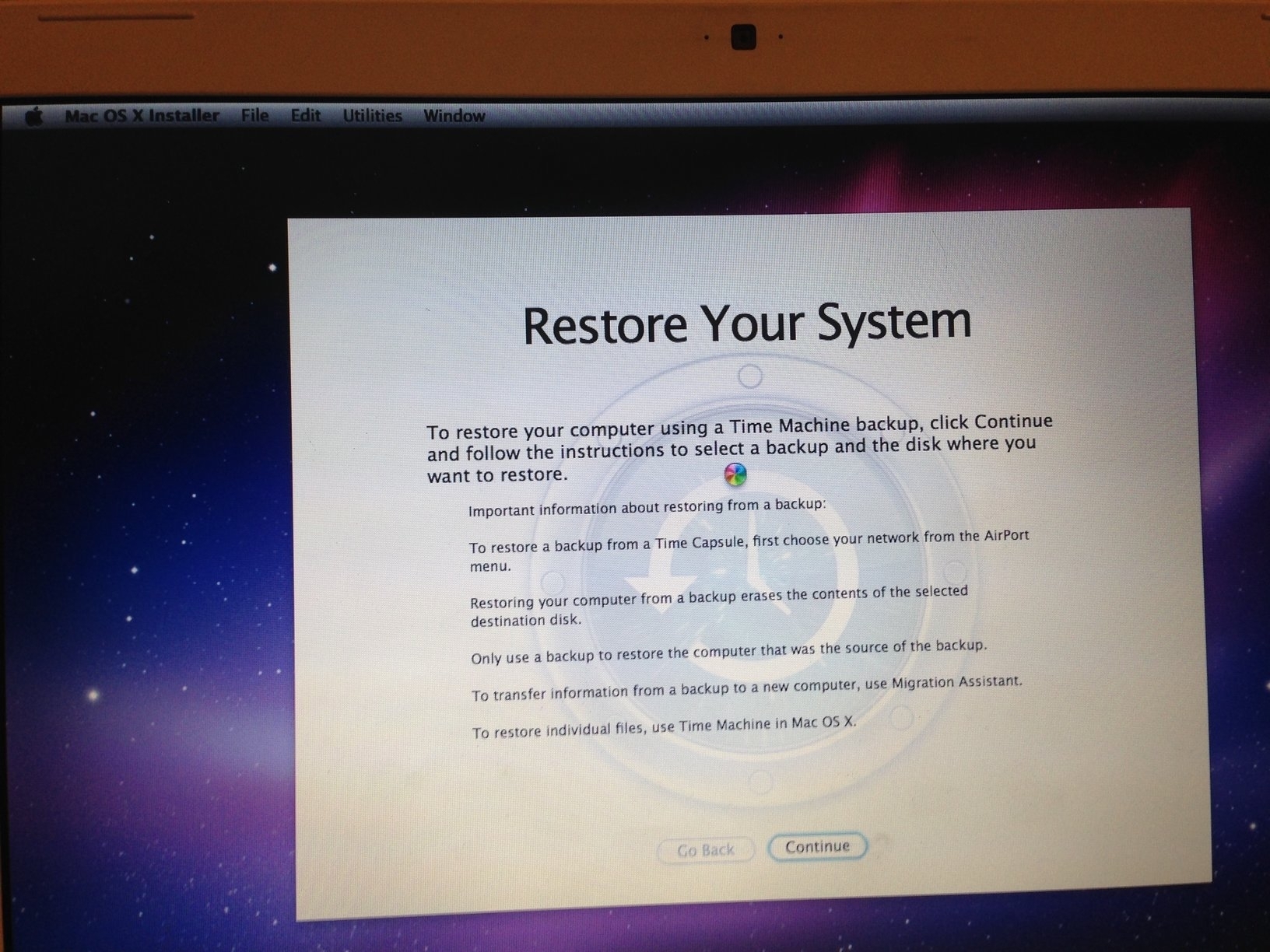

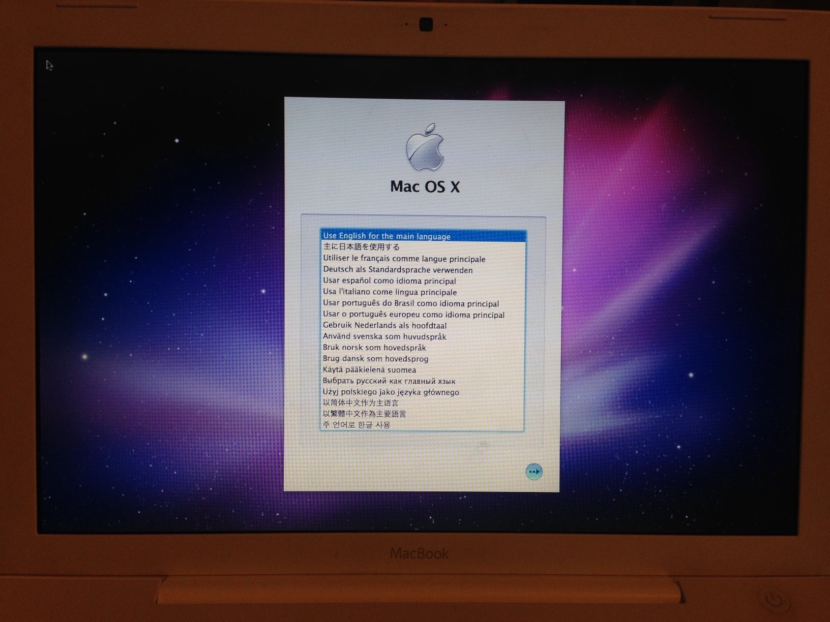

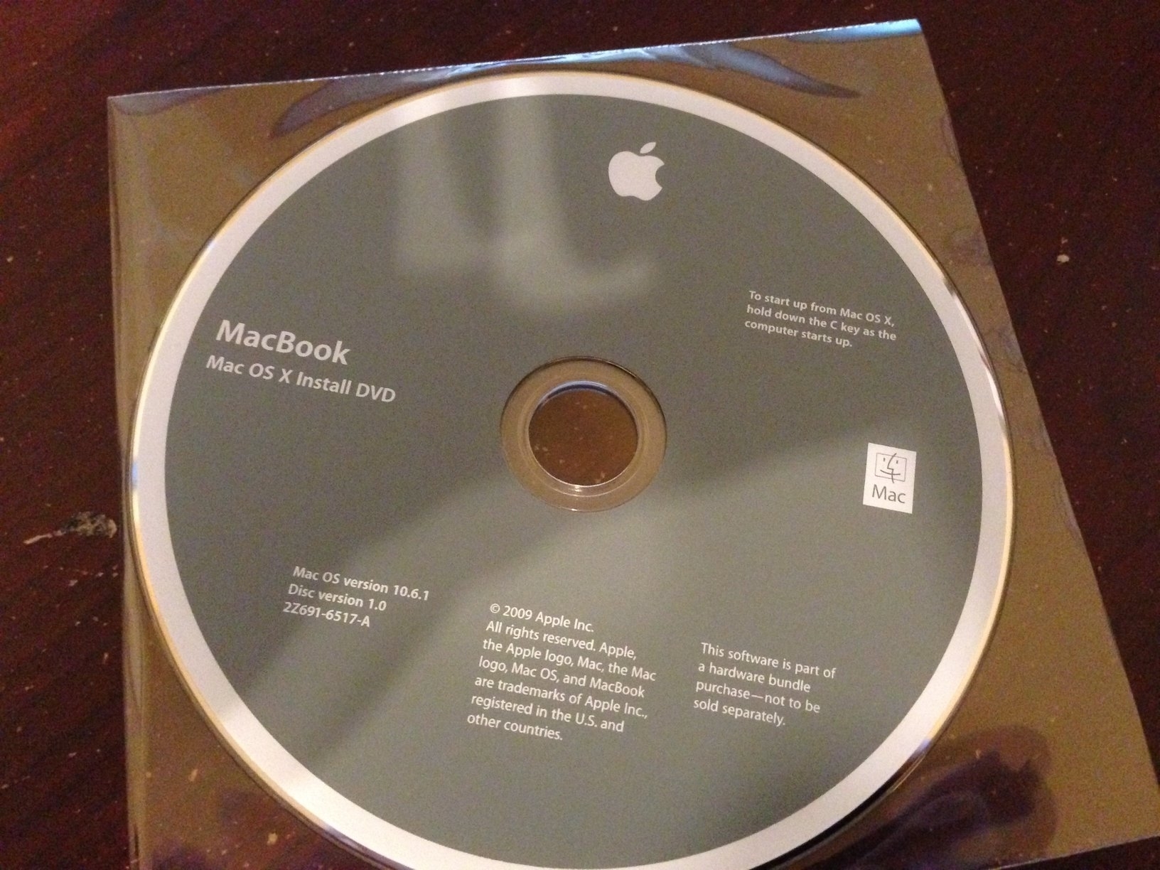

Sorry the photos had to be resized, but anyways here are the photos of what I'm seeing. It still won't let me install, even though I have done everything that you suggested. The bottom says 2007 for the date if that helps. I can go into system profiler to get more specs if necessary. Thanks again folks I greatly appreciate the help.

You need to get different restore discs as yours would not have shipped with 10.6 Snow Leopard.

Yes Chris is right : that grey disc (10.6.1) is specific to another model of Macbook, hence the message you got (can't be installed on this computer).
You can get a Snow Leopard (10.6.3) retail DVD from the Apple Store :
http://store.apple.com/us/product/MC573Z/A/mac-os-x-106-snow-leopard
Once installed, download and install the Combo 10.6.8 update, then run Software update to get all the security updates and other as well.
