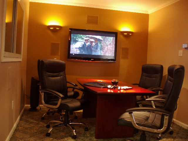

Here's a quick pic of the 46" Sharp mounted on the wall. The wireless keyboard and mouse allows the computer to be located in the next room. There's also an IR repeater under the left wall speaker to beam any remote control to the next room (so I can use a receiver remote or the mac remote).
The idea with this setup is that no wires are ever seen and components can be swapped out in seconds. Everything comes to a wall plate (including the HDMIs) so its easy and clean. Right now I'm using my macbook and a Playstation 3 to display content.
Sweet set-up. What kind of room is this? Is this in your house or some office meeting room?
I like the wall sconces and the paint color.
