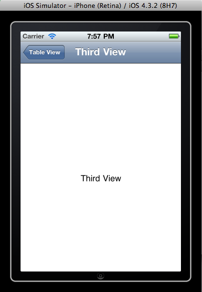

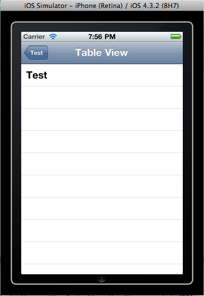

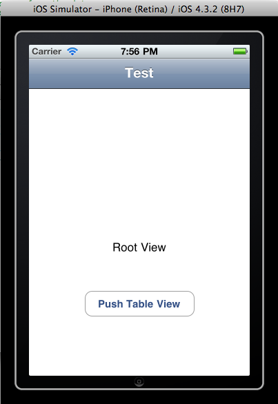

Here is the code I wrote. Maybe if you get stuck it will help.
RootViewController.h:
Code:
#import <UIKit/UIKit.h>
#import "TableView.h"
@interface RootViewController : UIViewController
    TableView *secondView;
    UIButton *button;
@property (nonatomic, retain) TableView *secondView;
@property (nonatomic, retain) IBOutlet UIButton *button;
- (IBAction) pushSecondView: (id) sender;
@end
RootViewController.m
Code:
#import "RootViewController.h"
@implementation RootViewController
@synthesize secondView, button;
- (IBAction) pushSecondView:(id)sender
    TableView *view = [[TableView alloc]
                                 initWithNibName: @"TableView"
                                 bundle: nil];
    self.secondView = view;
    [view release];
    [self.navigationController pushViewController: secondView animated: YES];
- (void)viewDidLoad
    [super viewDidLoad];
    self.title = @"Test";
- (void)viewWillAppear:(BOOL)animated
    [super viewWillAppear:animated];
- (void)viewDidAppear:(BOOL)animated
    [super viewDidAppear:animated];
- (void)viewWillDisappear:(BOOL)animated
	[super viewWillDisappear:animated];
- (void)viewDidDisappear:(BOOL)animated
	[super viewDidDisappear:animated];
 // Override to allow orientations other than the default portrait orientation.
- (BOOL)shouldAutorotateToInterfaceOrientation:(UIInterfaceOrientation)interfaceOrientation {
	// Return YES for supported orientations.
	return (interfaceOrientation == UIInterfaceOrientationPortrait);
// Customize the number of sections in the table view.
- (NSInteger)numberOfSectionsInTableView:(UITableView *)tableView
    return 1;
- (NSInteger)tableView:(UITableView *)tableView numberOfRowsInSection:(NSInteger)section
    return 1;
// Customize the appearance of table view cells.
- (UITableViewCell *)tableView:(UITableView *)tableView cellForRowAtIndexPath:(NSIndexPath *)indexPath
    static NSString *CellIdentifier = @"Cell";
    UITableViewCell *cell = [tableView dequeueReusableCellWithIdentifier:CellIdentifier];
    if (cell == nil) {
        cell = [[[UITableViewCell alloc] initWithStyle:UITableViewCellStyleDefault reuseIdentifier:CellIdentifier] autorelease];
    cell.textLabel.text = @"Test";
    // Configure the cell.
    return cell;
// Override to support conditional editing of the table view.
- (BOOL)tableView:(UITableView *)tableView canEditRowAtIndexPath:(NSIndexPath *)indexPath
    // Return NO if you do not want the specified item to be editable.
    return YES;
// Override to support editing the table view.
- (void)tableView:(UITableView *)tableView commitEditingStyle:(UITableViewCellEditingStyle)editingStyle forRowAtIndexPath:(NSIndexPath *)indexPath
    if (editingStyle == UITableViewCellEditingStyleDelete)
        // Delete the row from the data source.
        [tableView deleteRowsAtIndexPaths:[NSArray arrayWithObject:indexPath] withRowAnimation:UITableViewRowAnimationFade];
    else if (editingStyle == UITableViewCellEditingStyleInsert)
        // Create a new instance of the appropriate class, insert it into the array, and add a new row to the table view.
// Override to support rearranging the table view.
- (void)tableView:(UITableView *)tableView moveRowAtIndexPath:(NSIndexPath *)fromIndexPath toIndexPath:(NSIndexPath *)toIndexPath
// Override to support conditional rearranging of the table view.
- (BOOL)tableView:(UITableView *)tableView canMoveRowAtIndexPath:(NSIndexPath *)indexPath
    // Return NO if you do not want the item to be re-orderable.
    return YES;
- (void)tableView:(UITableView *)tableView didSelectRowAtIndexPath:(NSIndexPath *)indexPath
    <#DetailViewController#> *detailViewController = [[<#DetailViewController#> alloc] initWithNibName:@"<#Nib name#>" bundle:nil];
    // Pass the selected object to the new view controller.
    [self.navigationController pushViewController:detailViewController animated:YES];
    [detailViewController release];
- (void)didReceiveMemoryWarning
    // Releases the view if it doesn't have a superview.
    [super didReceiveMemoryWarning];
    // Relinquish ownership any cached data, images, etc that aren't in use.
- (void)viewDidUnload
    [super viewDidUnload];
    // Relinquish ownership of anything that can be recreated in viewDidLoad or on demand.
    // For example: self.myOutlet = nil;
- (void)dealloc
    [super dealloc];
@end
TableView.h
Code:
#import "ThirdViewController.h"
@interface TableView : UITableViewController
    ThirdViewController *thirdView;
@property (nonatomic, retain) ThirdViewController *thirdView;
@end
TableView.m
Code:
@implementation TableView
@synthesize thirdView;
- (id)initWithStyle:(UITableViewStyle)style
    self = [super initWithStyle:style];
    if (self) {
        // Custom initialization
    return self;
- (void)dealloc
    [super dealloc];
    // Release any cached data, images, etc that aren't in use.
#pragma mark - View lifecycle
- (void)viewDidLoad
    self.title = @"Table View";
    // Uncomment the following line to preserve selection between presentations.
    // self.clearsSelectionOnViewWillAppear = NO;
    // Uncomment the following line to display an Edit button in the navigation bar for this view controller.
    // self.navigationItem.rightBarButtonItem = self.editButtonItem;
    // Release any retained subviews of the main view.
    // e.g. self.myOutlet = nil;
#pragma mark - Table view data source
//#warning Potentially incomplete method implementation.
    // Return the number of sections.
    return 1;
//#warning Incomplete method implementation.
    // Return the number of rows in the section.
    return 1;
    if (cell == nil) {
    // Configure the cell...
    return cell;
    return YES;
    if (editingStyle == UITableViewCellEditingStyleDelete) {
    else if (editingStyle == UITableViewCellEditingStyleInsert) {
    return YES;
#pragma mark - Table view delegate
    // Navigation logic may go here. Create and push another view controller.
    ThirdViewController *view = [[ThirdViewController alloc]
                                 initWithNibName: @"ThirdViewController"
                                 bundle: nil];
    self.thirdView = view;
    [view release];
    [self.navigationController pushViewController: thirdView animated: YES];
@end
Code:
@interface ThirdViewController : UIViewController {
@end

The NIB files are pretty basic. Just labels and buttons to push the views. The button in the Navigation Bar is what pops the views off of the stack. You can see that particular button tells you which view you are going back to.

You've done more than enough. Before you posted that last page I managed to get my navigation code working perfectly. All I need to do now is display the correct information when a user selects a cell on the table which I know how to do. Your explination of the stack really helped me out 😀
perhaps I can sleep now :S
Thanks so much
