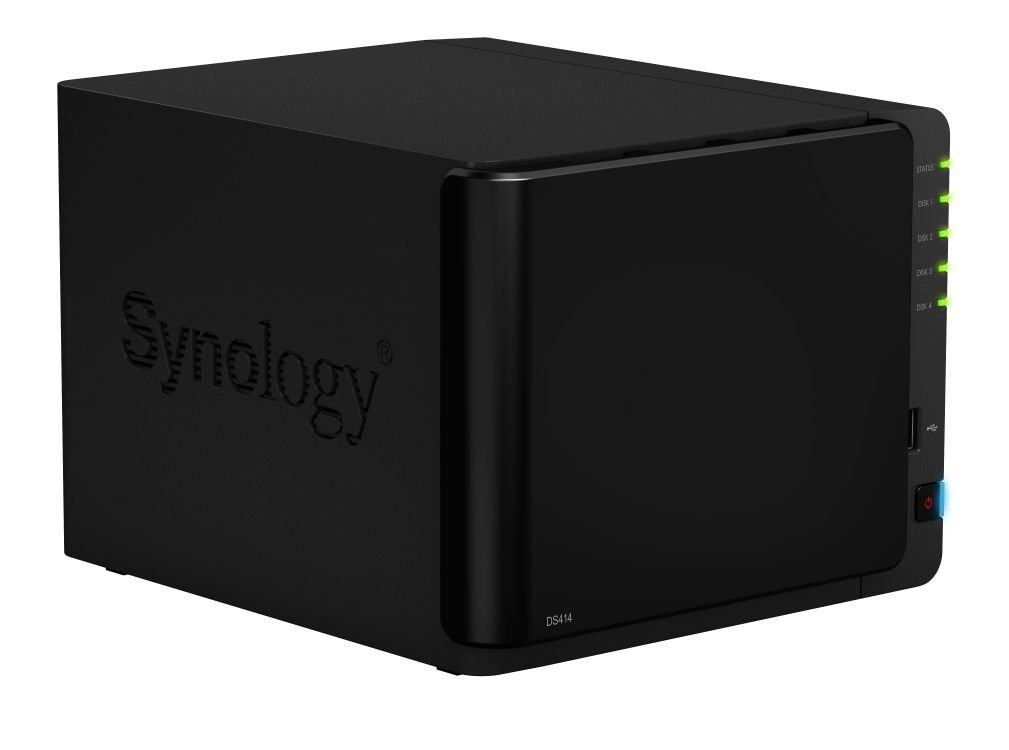

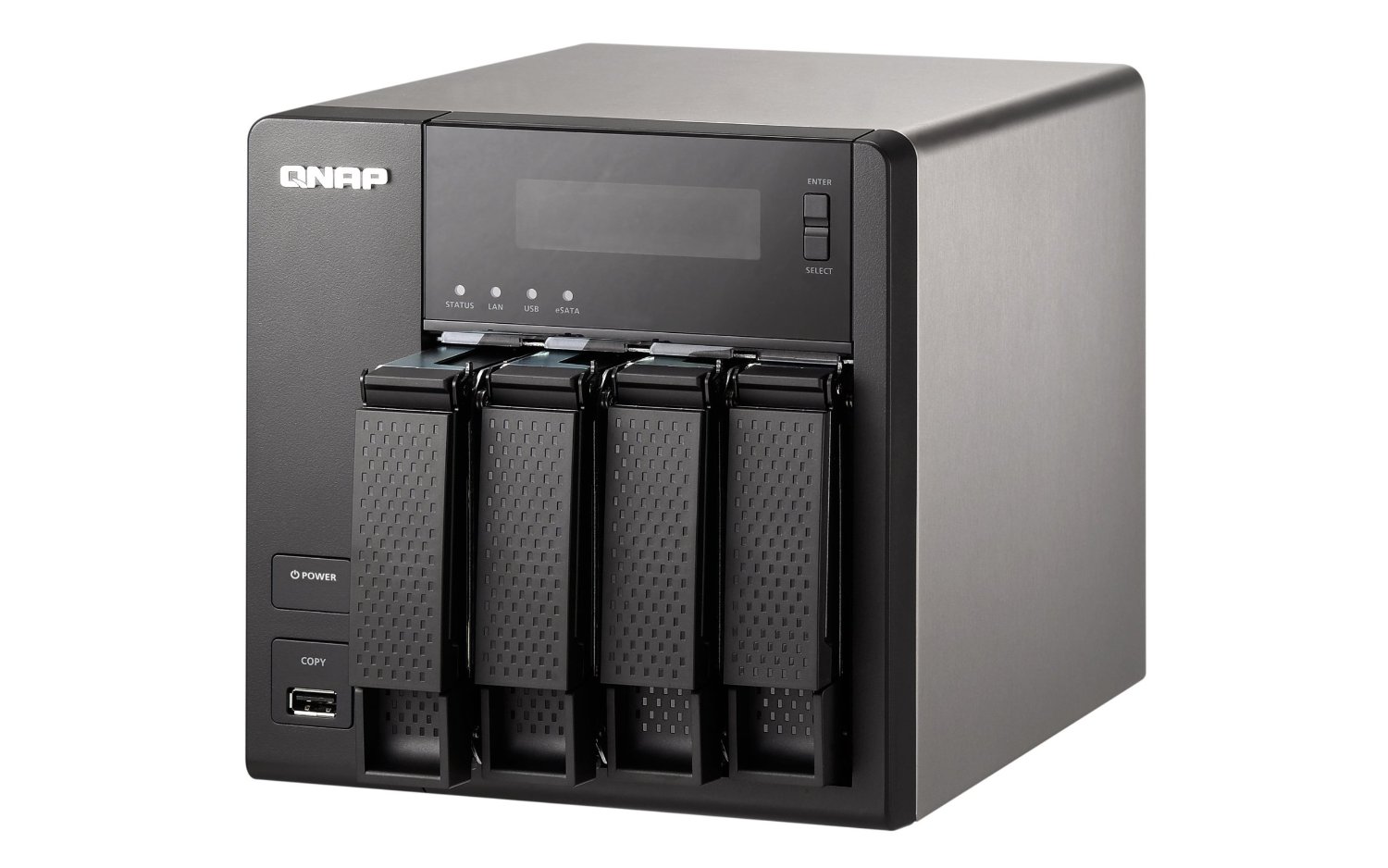

Both Synology (DS414) and QNAP (TS-421) have front USB sockets to backup flash drives (and CF drives via USB adapter) and USB 3.0 ports, both do iTunes sharing, Time Machine and cloud backup.
The Synology has a faster dual-core CPU and dual gigabit with link aggregation (if you happen to have a Thunderbolt Display to connect two ethernet cables to the Mac and a network switch that supports link aggregation, it doubles the bandwidth), while the QNAP has eSATA (which you could also achieve with an inexpensive USB 3.0 adapter).
When a hard drive fails, you simply replace it with a new one and it rebuilds the data. On the Synology, you can also mix and match different size hard drives, and if you happen to run out of space, you can simply replace the smallest with a larger one and the data gets rebuilt as well.
