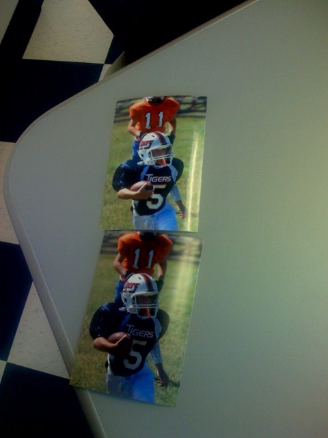

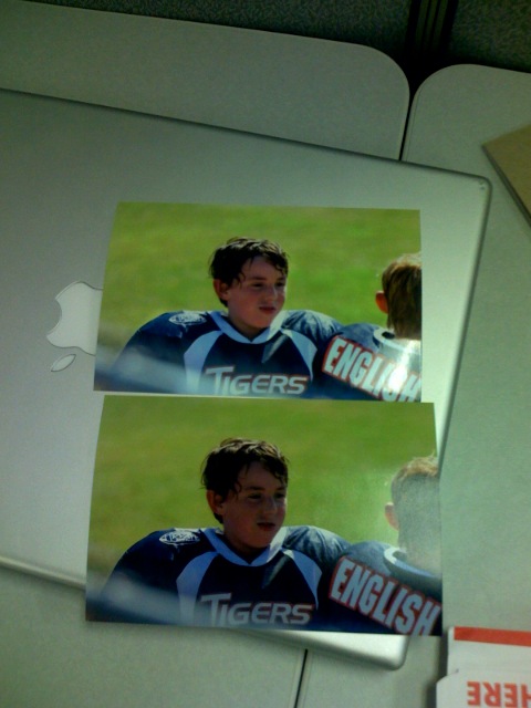

Im trying to upload a pic so you can see what Im refering to
This is not the best example but all I could do from work....The top pic is much lighter and bottom dark exp in face area...For example the pic above is what Im seeing on the web but when printing getting bottom pic...
Upon hper lighting and hyper saturation getting top pic. You can see more in person

Here is one more pic....same setup...
Can you see how dark the bottom is compared to the top
