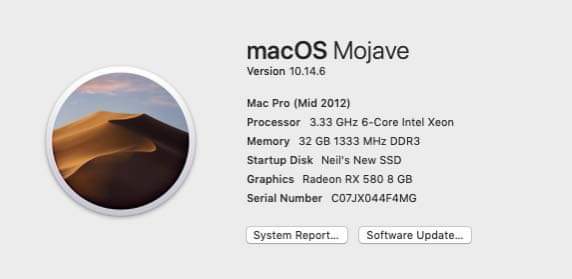

Here's the spec

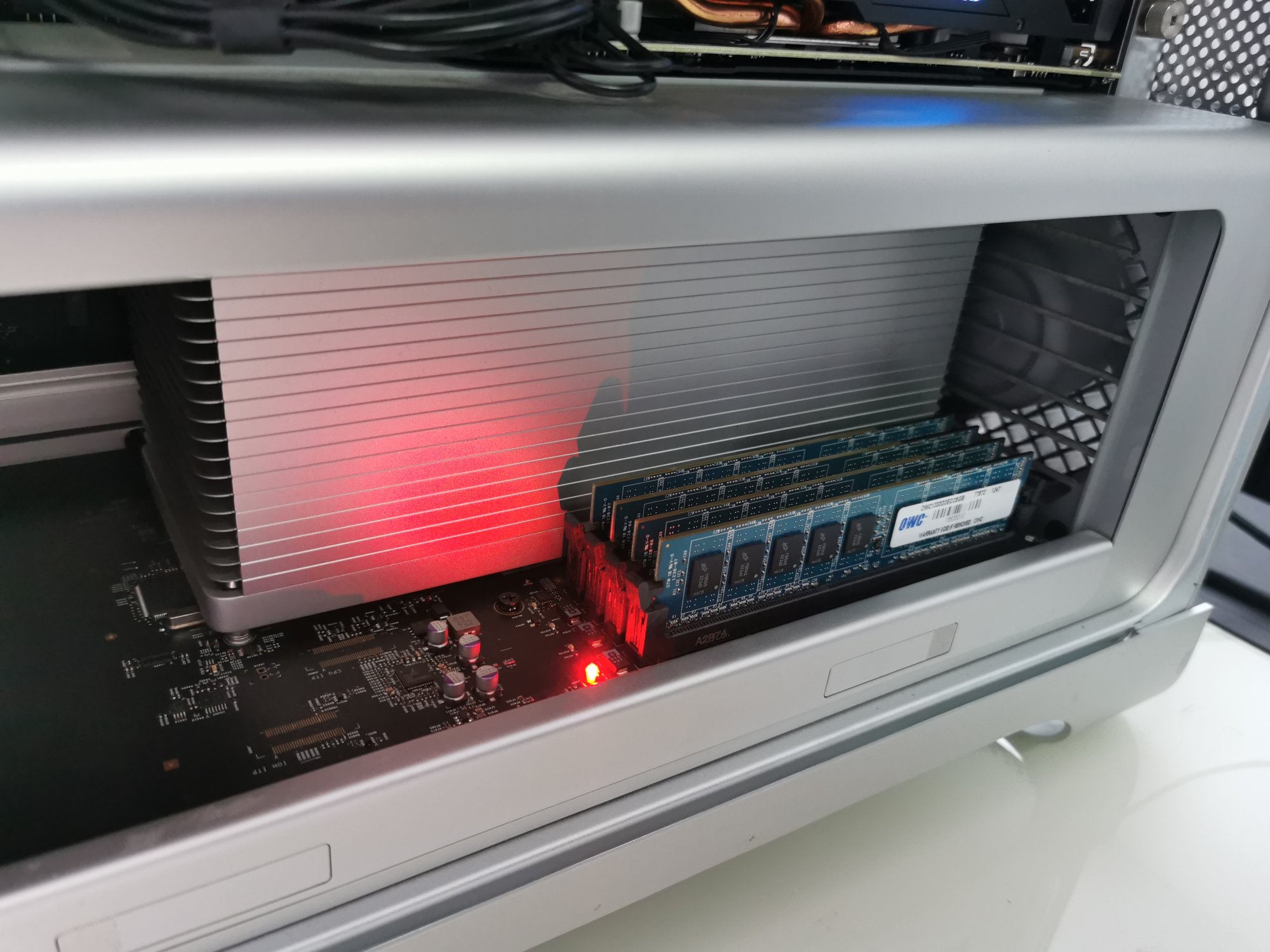

It looks like your red diagnostic light is on. So something is up. How new is that RAM? Did you mix two types from OWC. I also have all OWC RAM

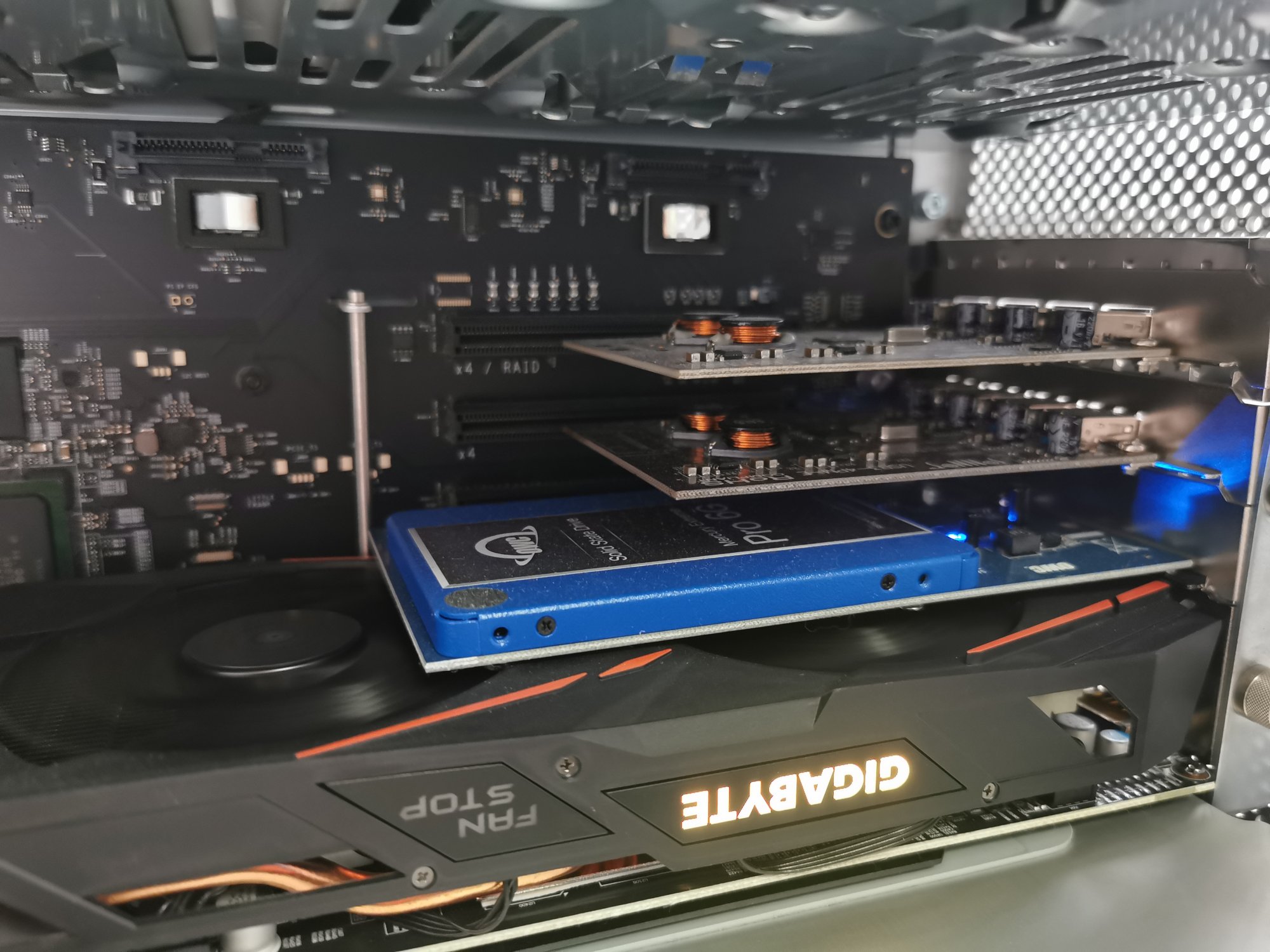

Or you can move your SSD from the PCIE slot into the normal place it goes in with an HDD sled this is what I mean by SATA boot.
I tried putting it in the optical drive but still got the blank screen but with a chime

if the red LED in the memory slot is still on > remove the DIMM

I instantly noticed this too. Hopefully it's just that one DIMM that is faulty and the system will boot just fine after removing it. I know the OP stated they ended up putting just one single DIMM in but they should confirm there are no RED error LED's lit up even with that one DIMM. They could have reinstalled the one with the error light on
Also the OP post is......curious. That is deff a single CPU tray pictured yet they ordered "dual 3.46 processor" which I am not sure if they are saying they bought two to install or that it is the X (dual config) CPU instead of the W (single config only) CPU? Scratching my head also at 96GBs of RAM on a single CPU tray....which would only be possible with 3 32GB DIMMS. Either way, we all know 96GB isn't possible on a single CPU tray so that IS a waste of money if they did not also upgrade to a dual CPU tray to utilize all that RAM.

Remove the memory module that is causing the red light on your CPU Tray . It will prevent your Mac from booting as the module has failed .

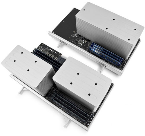

IMPORTANT : you have a single processor Mac Pro . You cannot install dual processors on this Tray . You'll need to buy a 2010 or 2012 model year ( it has an SMC version of 1.39f11 ) Dual Processor Tray first to install your pair of X5690s and 96GB of memory . Don't install a 2009 model year CPU Tray ( it has a SMC version of 1.39f5 - it is no good for you ) .
A single CPU Tray is shown on the top of this picture . A Dual CPU Tray is shown on the bottom :

I mistakenly thought that the red LED on the OP's CPU tray was for a CPU fault ( I'm not familiar with single CPU cMP config. )
I agree with other posters - power off if on and remove that RAM MODULE.

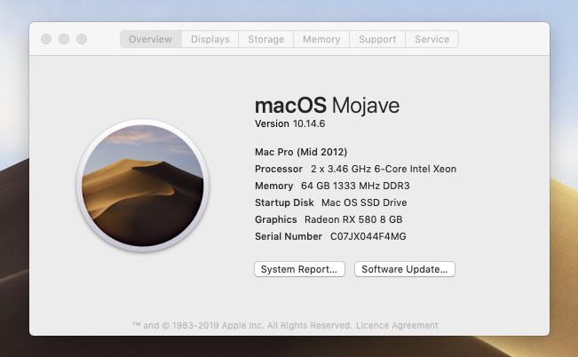

Update. So I just removed the SSD that has the problem and also removed all the internal hard drives except for a spare SSD that is in slot number one. I created an bootable install drive plugged that in and tried starting the computer holding the option key. I got the chime but still a black screen on the monitor.......... someone mentioned I need to get a EFI. GPU....... Can someone please link me to where I can buy one as I'm in Thailand
There isn't anything on your local Craigslist . There is one knowledgable Mac parts seller in Hong Kong . That's the closest I could find for you . Here's his store homepage .
At last......thanks everyone for all your input. Sorry if I pissed a few of you off but roughnecks don't make good IT guys.......I guess
