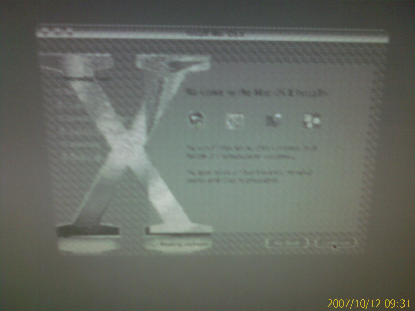

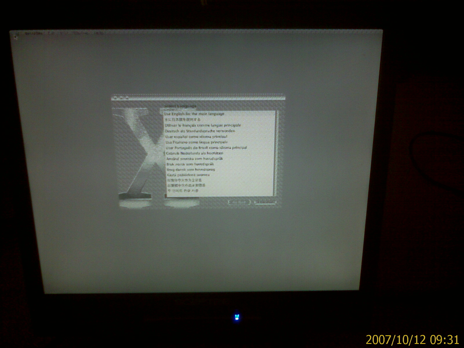

This is what the setup screens look like. As you can see its all garbled, and it remains like that, even after switching monitors, resetting P-RAM, and other things listed on the website. 🙁 I have no idea why it's doing this, and the problem is not with that particular G3, but rather all of the G3s I have, which since they were purchased by the school district, would be all the same model.
The CDs work fine in my G4.

You may need to install a firmware update to get your G3 running 10.3 (if you haven't already done that). I had to install the iMac Firmware Update 4.1.9 before I installed the OS to get mine running properly.
Check out this site for more info: http://docs.info.apple.com/article.html?artnum=86117
For the firmware update, how do I check to see if it already has the version that I want? I went into OF, and it said OpenFirmware version 3.1.1. Also, do I need to install Mac OS 9, update the firmware, and then install X, or can I just use an older version of X, to update the firmware, and then update to 10.3?
You should be able to run the firmware update in your early version of OSX. I'm not sure how to tell what firmware is currently installed, but I do know that the update will not run if it has already been previously installed... I guess just try and pick the most likely of the available options. Good luck!
The Apple website says I would a Mac OS 9 system folder installed on there, which I do not have. So it looks like I would have to try to install Mac OS 9, update the firmware, install Mac OS X, sounds like a lot of hoops to jump through. Is there an alternate method to updating the firmware that is much easier and convienient, such as by booting off of a CD?
I would try to figure out which graphics card is installed.
It definitely seems that your card simply isn't supported by this version of OS X.
I have a 3Dfx Voodoo 5 5500 card in one of my B&W G3's, and the screen looked very similar to yours when I tried to install 10.3.
