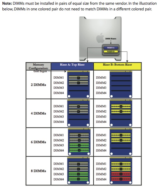

I'm the owner of a new mac pro, and I recently bought 4gig of ram from OWC. I installed the ram correctly - two gigs per stick, shuffled the old ram down to the second slots installed the new ram in the first slot on the top and bottom.
However, the mac's only recognizing the new 4 gigs in the first slot. I was pretty static safe, touching my case in all the right places every few minutes and not moving. I'm pretty sure I haven't killed anything.
Any idea what could be wrong? Is there some little bite of common knowledge someone is keen to share?

have you installed the FB_DIMMS correctly? from the Mac Pro service guide:

I don't know what manual you are reading, but when I go to Apple's website and look at the Mac Pro early 2008 manual, it shows you are to install it the way you have it installed now. I don't see anywhere where it states to install it the way you originally installed it.
On the bottom memory card, open the ejectors on the DIMM slot and push them out
to the sides, and then remove the DIMM from slot 1.
Important: When installing or removing DIMMs, don’t touch the gold connectors on
the DIMMs or the memory cards.
4 Reinstall the DIMM you removed on the top memory card by aligning it in DIMM slot 2,
as shown in the illustration, and pushing both ends of the DIMM down until the tabs
are vertical and the ejectors snap into place.
5 Install the first pair of additional DIMMs on the bottom memory card in DIMM slots 1
and 2, the slots closest to the card’s gold connectors.
Important: Always install DIMMs as matched pairs and in the order shown here.

As the documentation Roy quoted above states, pairs in any single riser must be matched capacity. From what I can determine from your "experiments" your current setup would have a 2GB Apple chip in the same riser with a 1Gb Apple chip, in which case only the one in the first slot will be recognized because of the unmatched pair.
Also as he noted, the matched pairs in a single riser is for the MacPros introduced in Jan. 08. The previous generation MacPros had a different method of addressing memory more along the lines of what you were describing originally (2+1 in each riser).

Both the older and the newer MacPro require RAM to be installed in pairs, on the same riser. Populate your slots, starting with the largest RAM pair, in this order
A1
A2
B1
B2
A3
A4
B3
B4
The 2008 MacPros ship with the Apple RAM in the A1 B1 positions, this is NOT to be maintained when you add more RAM. Move the Apple module from A1 to B2
To the OP:
First make sure you have the OWC RAM in A1 A2 and the Apple in B1 B2
Do you have a red LED shining on either of the memory riser cards?
What happens if you swap cards between the card sockets?
(Always shut the machine completely off when moving memory or risers)
