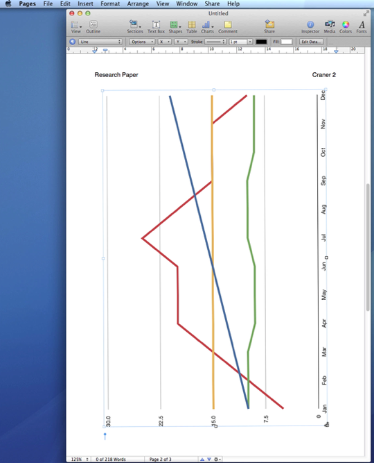

Actually you can rotate Numbers charts in Pages. Move the mouse to the bottom right drag handle and press the ⌘ key, the resize pointer will change to a rotate pointer, you can then rotate the chart by 90% for landscape orientation.
