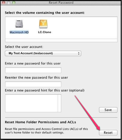

Try this.
Restart your computer from the recovery partition by booting while holding command-r keys both at the same time.
While in recovery open Disk Utility and run a permissions repair on Macintosh HD. Quit Disk Utility. (this part is not the real fix... but it is a good idea while we are here)
Open Terminal from the Utilities menu. Type in "resetpassword" and select your user account from the drop down menu, then click the Reset button at the bottom of the window in the Reset home folder permissions and ACLs section.
Quit the Password Utility and go back to the main recovery screen. Now restart.
Edit: There are some screenshots here that will walk you through.

May I ask what the second step is for, I know reset password but is this needed?
so should i also try this (then click the Reset button at the bottom of the window in the Reset home folder permissions and ACLs section.)
Thanks
We are not actually resetting the PW, you just need to access this screen and click "reset" to reset permission and ACLs for the selected user. This will put home folder permissions back to default and should fix this problem.
ACL is "access control list" and is just really a more fine grained permissions method.
Thanks
You don't need to enter anything in the password fields on that screen. Just click the reset at the bottom right.
I know it is confusing because you typed "resetpassword" to get here, but we are not reseting the password. You just have to type that in to get to this screen.

Correct. After you get to that panel and click the reset button, you need to command-q to actually quit everything or the reset will not happen.
What you would not want to do is after you click the reset just hold down the power button to turn off the machine. Although even if you goofed and did this, you could just repeat it the correct way and it would work.
Just give this link from my earlier post a good look before you start. The screens look just like on that page. You will be fine. 😀
Thank you, fingers crossed for me then 🙂
