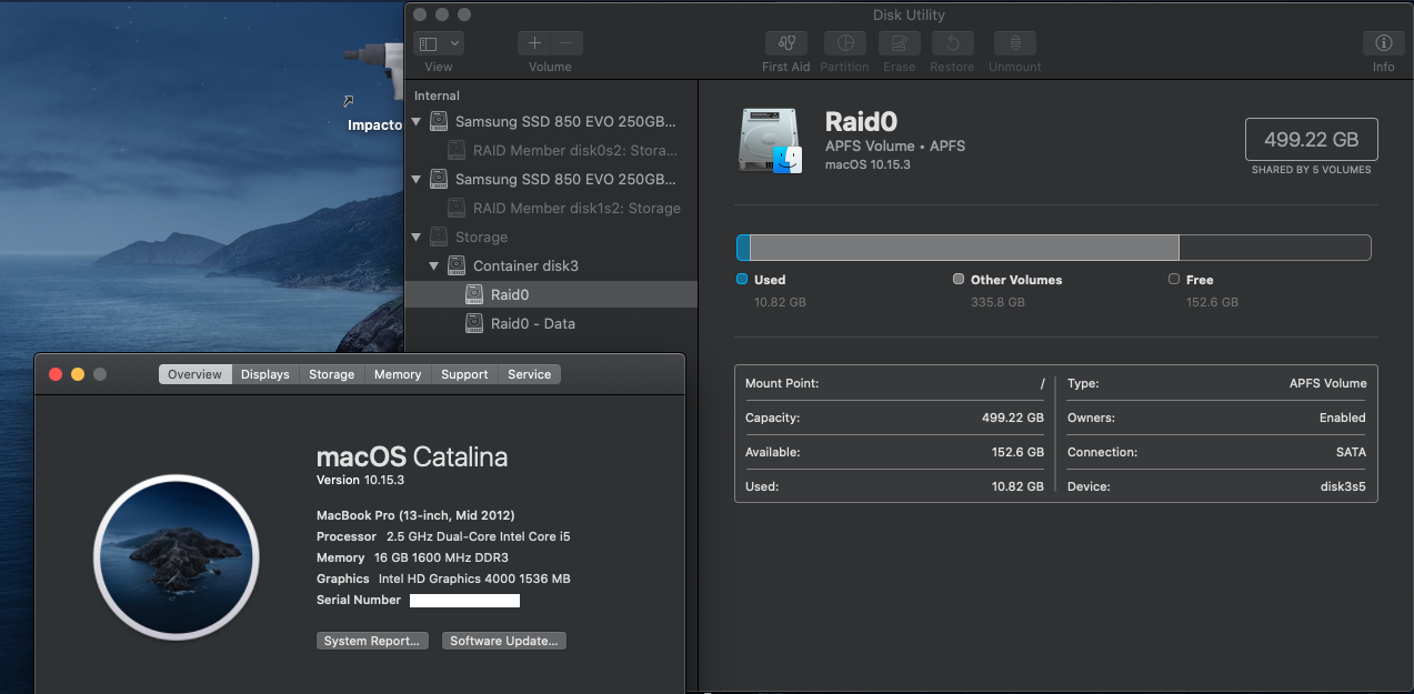

you have not mention which MacOsx you'll be using for this Raid0 setup, High Sierra Raid0 (HFS+ formatted) will be the easiest.If your choose either Mojave Raid0 APFS and Catalina Raid0 APFS is a different animal, i believe since Macosx 10.13 apple remove to boot from Raid setup, so create GPT partition, make your Raid0 volume thru terminal commands, install catalina , rename your bootcaches otherwise boot loop will occur, Ive use migration assistant restore my programs and settings, this method works for me as Catalina Raid0 APFS with my 2012 Macbook Pro. Good luck.
