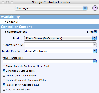

OK I looked at a file I saved in Property List Editor and it's saving all the values as 0, so save isn't actually working at all. If someone with some Cocoa experience could please look at this I'd be very grateful.
You have to tell your object controller what it's controlling. The values aren't getting saved because the bindings system isn't even setting the values of your variables in the first place. In this case, you want it to link to the detailsController in your document, so in IB, bind the "Controller Content" of objectController to File's Owner (your document), with the path as "detailsController".

Thank you so much! 🙂 I'm very new to Cocoa and rushed through the Hillegass book a bit, that was a really stupid mistake to make.
