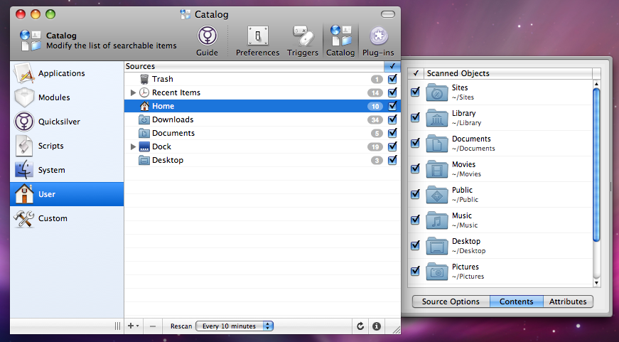

Using Leopard 10.5.4, and I've noticed that searching in Spotlight does not bring up all results. For instance if I search 'widgets', I do not get a result for the Widgets folder located in ~/Library/.

Also with Quicksilver, typing in 'widgets' does not give the desired result, even though the Library folder is selected for search,I think?. (see pic)

Quicksilver definitely doesn't search ~/Library by default and you image only confirms that it's searching ~ one level down and finding the Library folder itself, but not it's contents. You can create a custom catalog source using the File and Folder scanner (see the + button at the bottom of the catalog screen) to do so, but be cautious about putting too many things into your catalog and slowing down QS.
An alternative is to use QS to navigate to items. Activate it (control-space), type ~ to get to your home folder, type / to move down a level, type Lib to select ~/Library/ and continue this way until you find the file you want.
