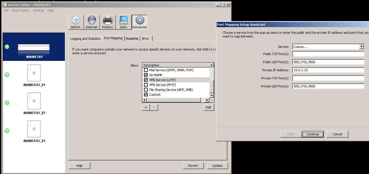

I have local vpn and file sharing up and running but have ran into a problem setting up non local. Probably need help with port forwarding maybe.
I have
lion server
airport extreme
mac book pro
Any help would be much appreciated as i've been slamming my head against the wall trying to get it to work.
just change the internal value to whatever the IP address is for your server:
Thank you much, got the vpn working!!! figured I had the ports fraked up. i had used the airport disk before on the airprot extreme and it was using the port i needed for it.
