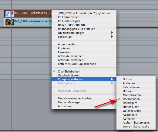

But what I meant with blend modes will work in FCP. Just put the same to clip on top of itself, right or ctrl click on the top one, select compostion modes, screen? (I hope that what it is call in english, if not it the one underneath multiply)
