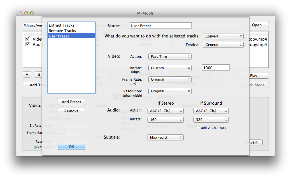

I'm afraid Subler can't be used in batch mode for this kind of conversion. However, (the beta AND non-free version of) MP4Tools can: I've tested it and it works just fine with batch conversion.
Just create a new preset to be used in batch mode:
And this is how you can 1, make this preset the default and 2, force the system to always select all tracks from every batched video:

Okay, I bought MP4tools and I'm having a problem. When I encode audio, I set it up so that if it's stereo to encode for AAC (tv shows that are stereo) but if it's surround then pass through the ac3 and add a stereo track for my current setup. As for the video, I just set it up as pass through. Here are my settings:

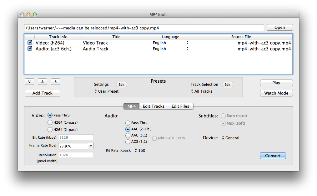

And here is the settings before I hit convert:

There seems to be a bug with teh latest b15 version (did you update to it?): the first file converted upon drag-and-dropping a bunch of files to it won't have the added AAC audio track, only all the other files (with the settings I've shown). That is, make sure you duplicate the first file OR pass a dummy file as the first in the filelist you drag from Finder to MP4Tools. The rest will have both (AC3 + AAC) audio tracks, it's only the first that won't.
