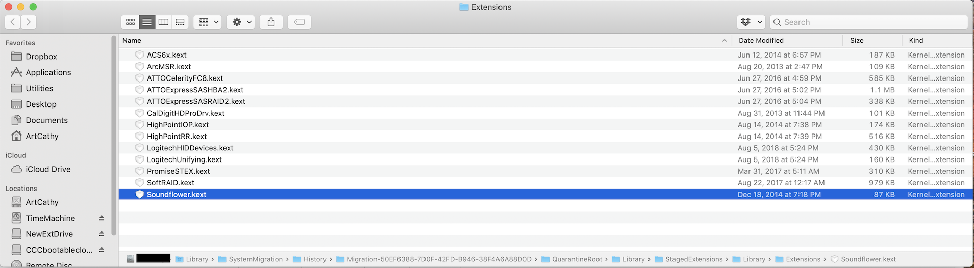

Thanks, revmacian and MacUser2525. I followed the instructions--a few times, but even though I can still confirm the location, Terminal tells me the file doesn't exist. Am I doing something wrong?
You do nothing wrong the file does not exist on your system it tells you so, just like my output showed. The .kext file is there but not the file you try to delete.

MacUser2525: EasyFind and Finder both show the file's location. So how could it not be there?
It shows the .kext file not the file inside you try to delete that is is not present. Now I know you want to delete the entire file.

SUCCESS! It's Gone! Terminal was still telling me "no such file or directory," so I went into Finder and started with the SystemMigration folder, drilled down to the file, and simply sent it to Trash. I rechecked with EasyFind to make sure it was gone. I don't know why I couldn't do that before. Maybe that was before I disabled SIP. Now I need to re-enable SIP. Thanks, all!
