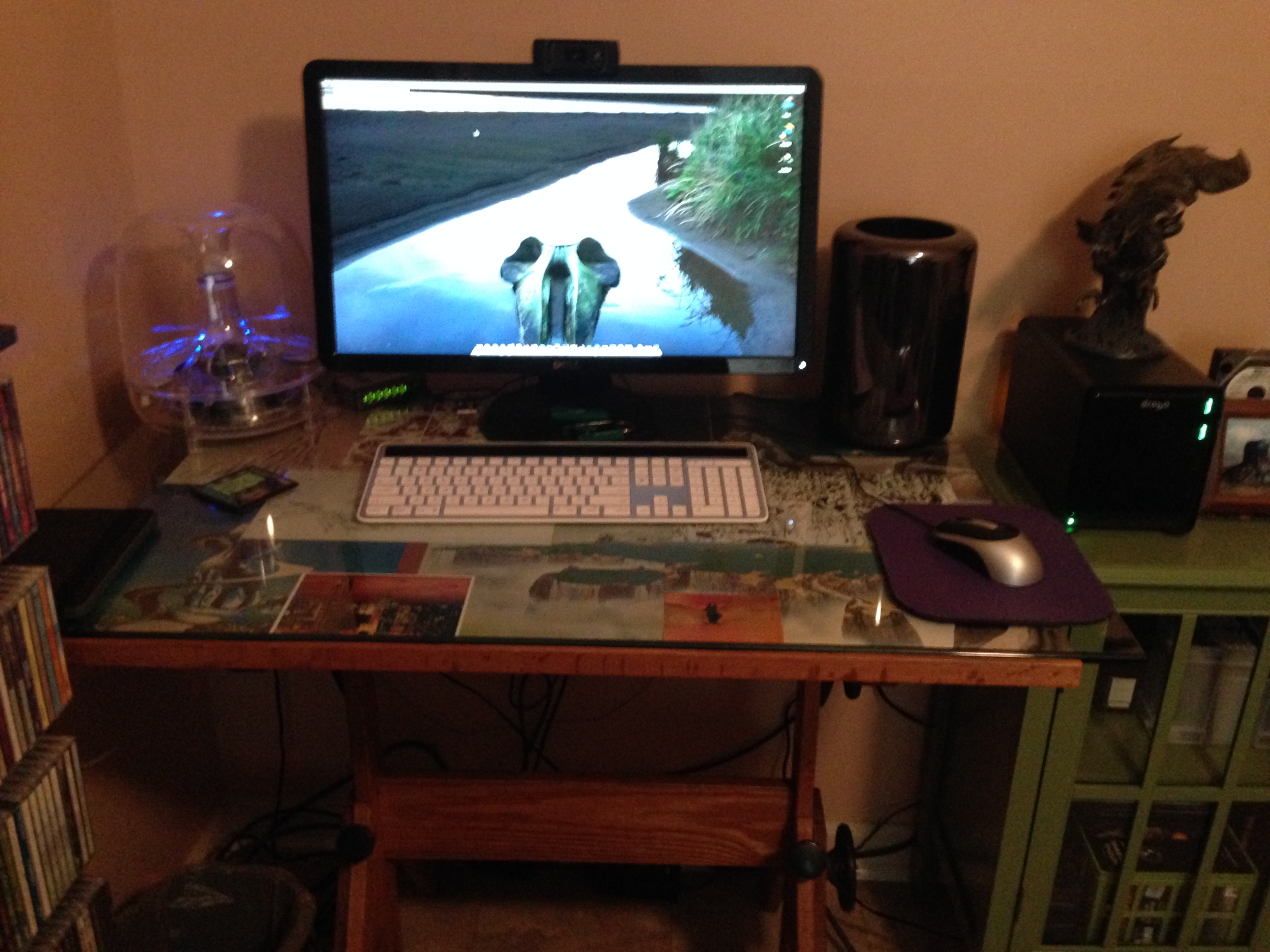

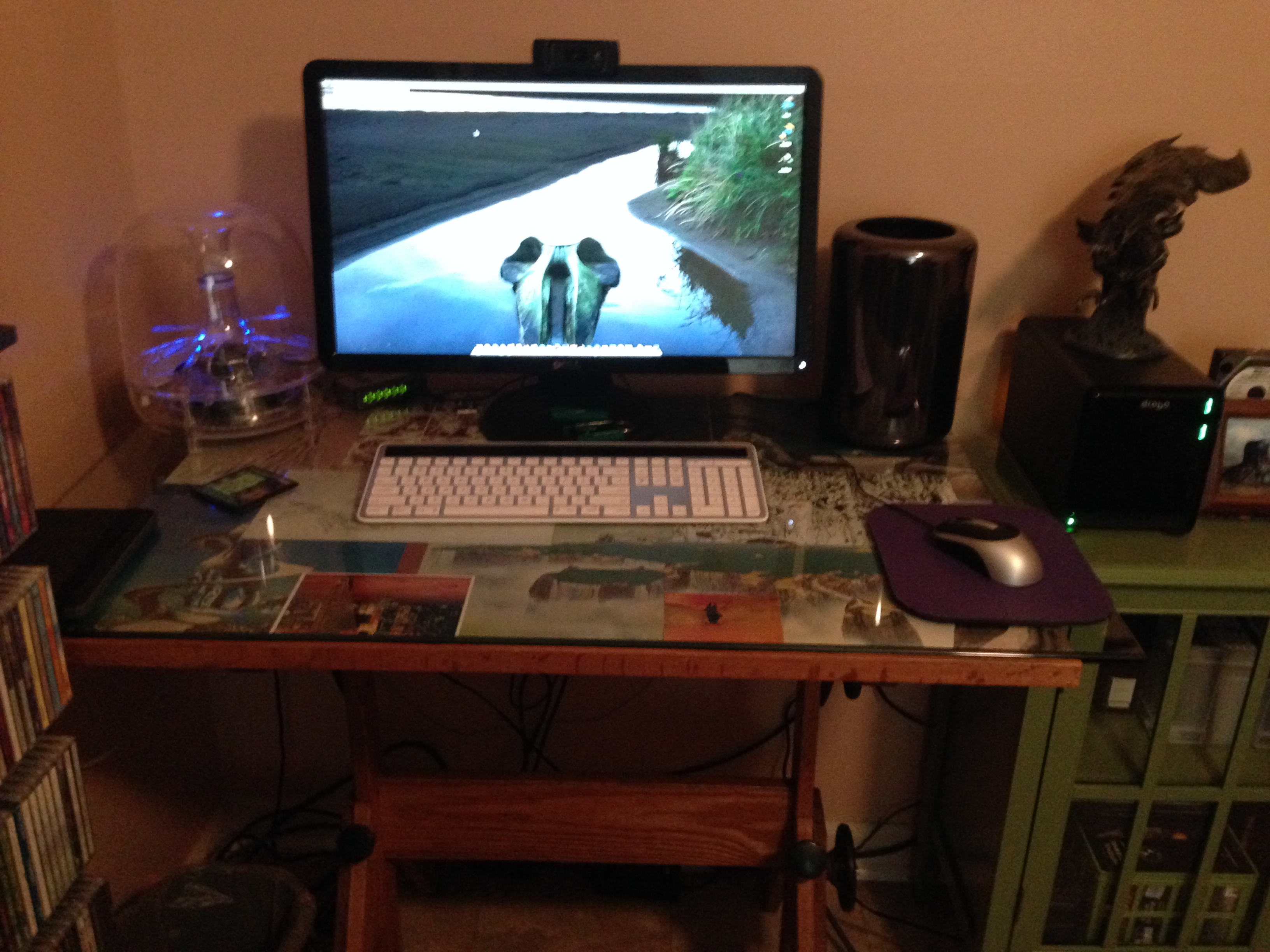

I have a Drobo 5 bay (3TB each), 2 WD 3TB and 1 WS 2TB drives attached via the usb. My 4th USB is attached to a 7USB port. I don't currently own anything that uses the Firewire ports and my monitor uses HDMI. I can see all my HDs on the desktop and actually have my iTunes directed to one of these drives. You can tell your machine if you want to view the HDs. Yes, you can split your drives by formating them any way you want.
Look on upper right hand of monitor.
