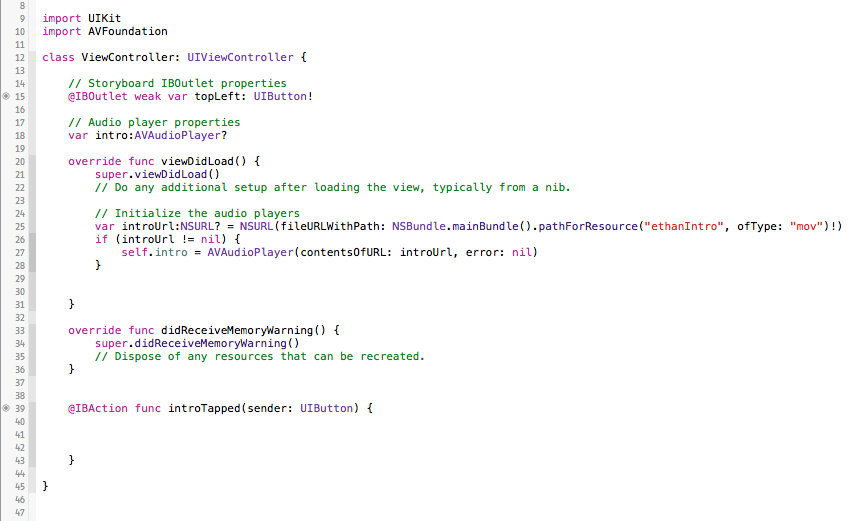

I am trying to develop a soundboard application for iOS and have been getting myself familiar with xCode and Swift for around 2 months now. I've just started to create my own application and have come across a little problem. From the image below, I believe all my code is correctly referenced right now I just don't know how to play the sound when the button is tapped. Any help is appreciated.

Your button method is empty i.e.

[COLOR="Red"]You need some code here to play the sound[/COLOR]

What kind of code would I put there though? I have tried something like
Code:
if (self.flipSoundPlayer != nil) {
    self.flipSoundPlayer?.play()
but that doesn't work, no sound plays at all. I don't know the right format to put there to get the sound to play

What is self.flipSoundPlayer ? According to your first attachment shouldn't that be self.intro?
