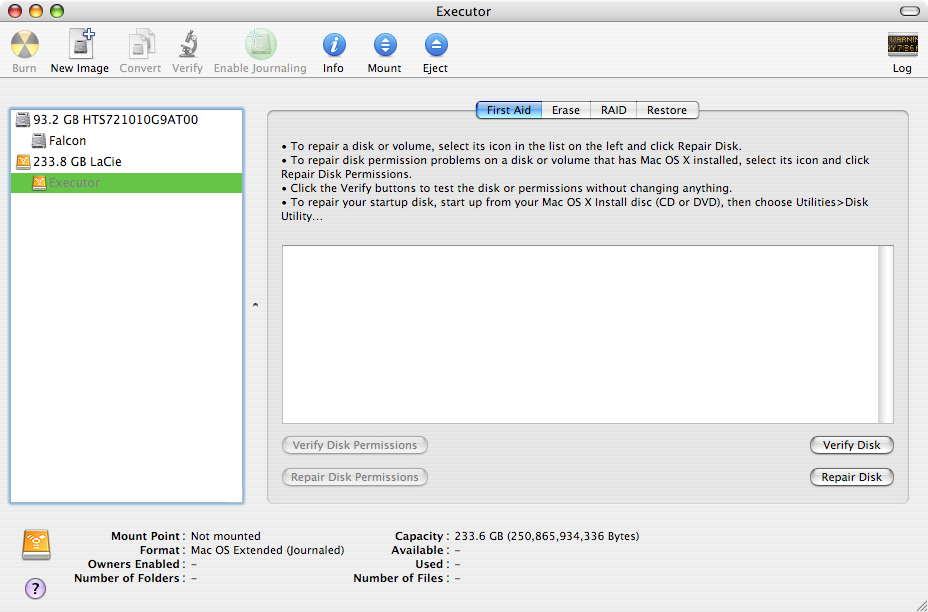

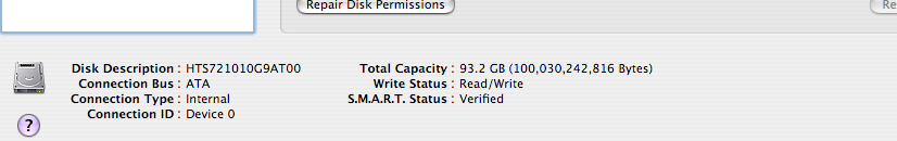

It's in Disk Utility, at the bottom when you've selected the drive.
It's not 100% accurate, but can be a good indication of a failed drive, or an advance warning of a drive that's going to fail.

Yes, SMART status is verified. Everything else looks like yours minus the GB numbers, etc.
Two things- It took forever to get disk utility to come up with the drive info (1-2 minutes).
when I select the Icon and name of my hard drive "trout" at the bottom it says the following:
Mount point: Not mounted
Format: Mac OS Extended (JOurnaled)
Onwers enabled: -
Number of folders: -
Capacity: 55.8 BG
Available: -
Used: -
Number files: -
so missing this info can't be good- but what does all this say about my drive health though.
What is next step-
thanks again for your time
Oh yeah, when I was waiting for a response I just shut the lid to the ibook to put it to sleep. when I opened it the iBook was shut down for some reason. Can a computer that is booted up to a Install DVD be put to sleep this way or is this indicative of a problem?
Well, I Unmounted my external hard drive, and clicking on the grayed name of the unmounted drive yields the attached screen.
So that's not too unnatural. Is the Mount button grayed out when you've got your drive name selected?

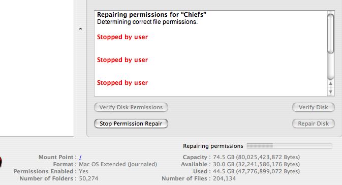

<<<<Side note- I am not having problems with my iMac now! UGGG! I have not had issues with either of these for a year or more!! Anyway, I went in to repair disk permissions with disk utility on it and the DiskManagementTool died? It said Disk Utility needs to be restarted. I click OK and it said "do you really want to do this as it might make the disk unusable" I said no and it want back to trying to repair permissions. It didn't move for a while so i clicked the button to "stop permission repair" Now disk utility is not progressing anymore and is stuck. computer is working fine right now though. Below is the log and I will attach a screen shot too. What should I do for this?
Mar 8 11:21:57: Disk Utility started.
Repairing permissions for “Chiefs”
Determining correct file permissions.
DiskManagementTool has died. Disk Utility will need to be restarted.
Stopped by user
Stopped by user
