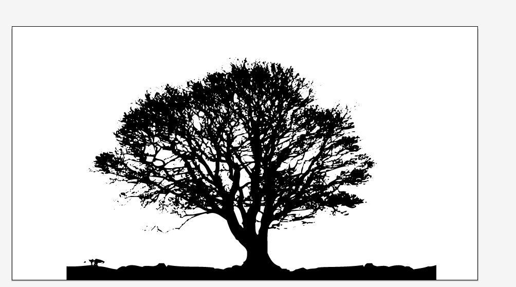

I took a look at the file and what I did was mode CMYK and deleted the CYM and level adjusted the K. Converted to greyscale and then erased some of the sky bits. Copied into Illustrator and then live traced and come up with attached in about 5min.
