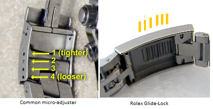

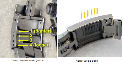

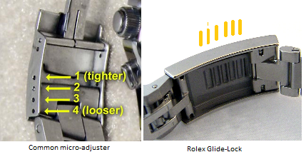

Part of this has been discussed before:
Your uncomfortable fit problem is a design flaw with Apple's link band. Unlike almost all other link bands, Apple did not include a way to do micro-adjustments (changes that are less than a link's width).
I have a variety of link style bracelets on my other watches. As you've pointed out Apple's link is quite a departure from those. One that lacks the customary ability to make fine adjustments.
