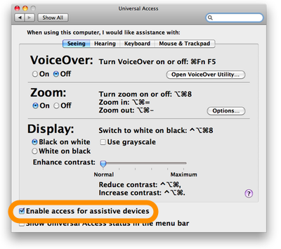

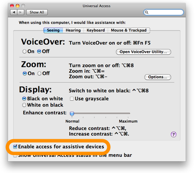

In order for the "System Events" application to use the key code or keystroke commands, you have to enable Mac OS X's accessibility frameworks."System Events" will send a key code or a keystroke to the frontmost application.

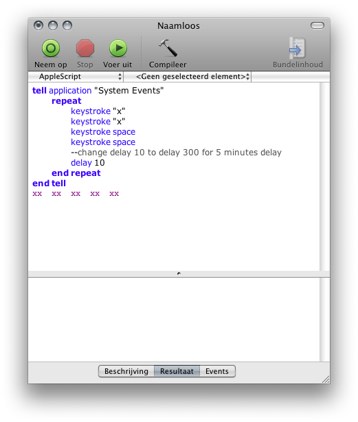

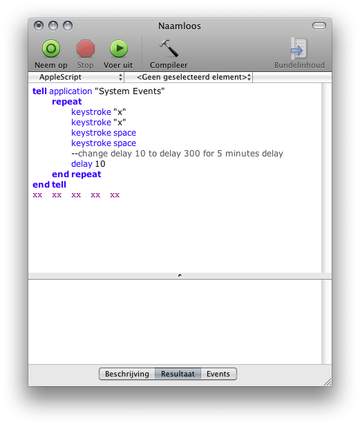

Paste code in scripteditor :
Code:
tell application "System Events"
	repeat
		keystroke "x"
		keystroke "x"
		keystroke space
		keystroke space
		--change delay 10 to delay 300 for 5 minutes delay
		delay 10
	end repeat
end tell
Don't know if the duration of the keystrokes can be 1 second long.
Will result in this as the frontmost application is scripteditor :

Also how does the delay work
I thought this line explains what you must change :
Change delay 10 to delay 300 for a 5 minutes delay. Delay is in seconds so
60x5=300 seconds = 5 minutes.
The script will continue to run untill you click stop in scripteditor
