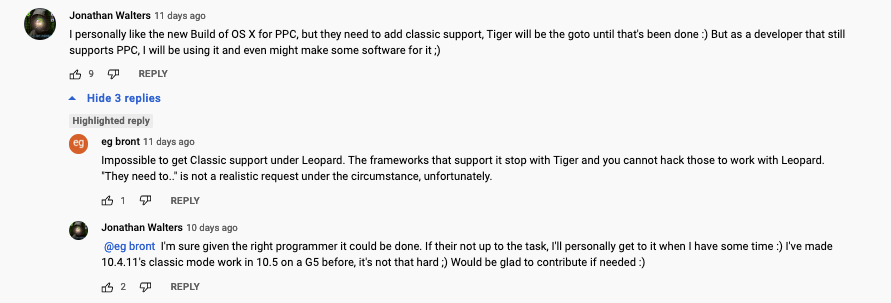

I was actually the one that posted the question to @z970 and am glad to see it getting some traction! In my own opinion, if Leopard had classic support, I wouldnt need Tiger at all now with the new Sorbet Leopard.
Reactions: z970
I like Tiger a lot, but it would be very interesting to see what Leopard can do with Classic apps. I'm wondering furthermore that, if we can ultimately trick Leopard into running Classic, why couldn't we roll up a way to dual-boot OS9? I'm aware that firmware limitations currently prevent this sort of thing, and obviously driver support for G5-era hardware on OS9 would be a problem to be overcome, but I've seen stranger things come to fruition. The Apple Nerds are crazy hardcore when it comes to challenges like that.
