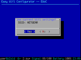

If you're interested, i'm attaching a bash script to handle connecting to wifi. We used this on the ZipitZ2 back in the day. It will need slight modifications to work on current linux.
Cheers
Cheers
Thank you! I will take a look at it.
