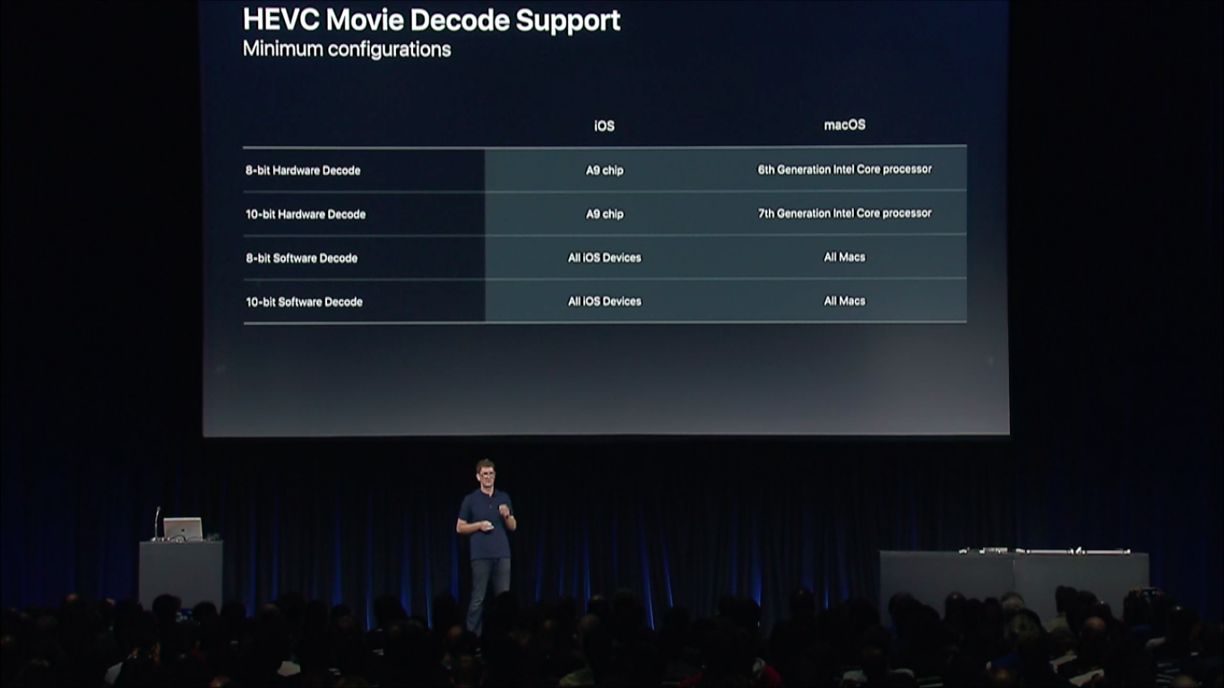

HEVC hardware decoding requires A9 and up. So iPad 2017 and all iPad Pros support HEVC hardware decoding on iOS 11. It's only hardware encoding that requires A10 and up.
I wouldn't read much into the 'specs' on the website - this was all confirmed during WWDC 2017.

The native video player supports hardware hevc decoding on A9 and up, which all iPad Pros do, so yes.
That said, in true Apple fashion, the video must have the new codec ID of hvc1 to work with the native player, many earlier HEVC videos will have the codec ID hev1, so a remux could be required if you wanted to use the native player with ‘older encodes’. MKV containers are also still unsupported.
I guess that is one advantage of third party apps in that they will use hardware decoding for all hevc videos regardless of codec ID including videos contained in an mkv.
