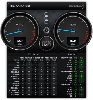

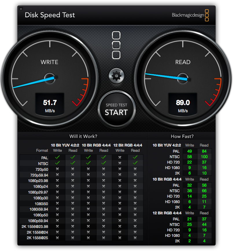

Here's the sustained performance of an Extreme Card using built card USB 3 reader on the Mac.

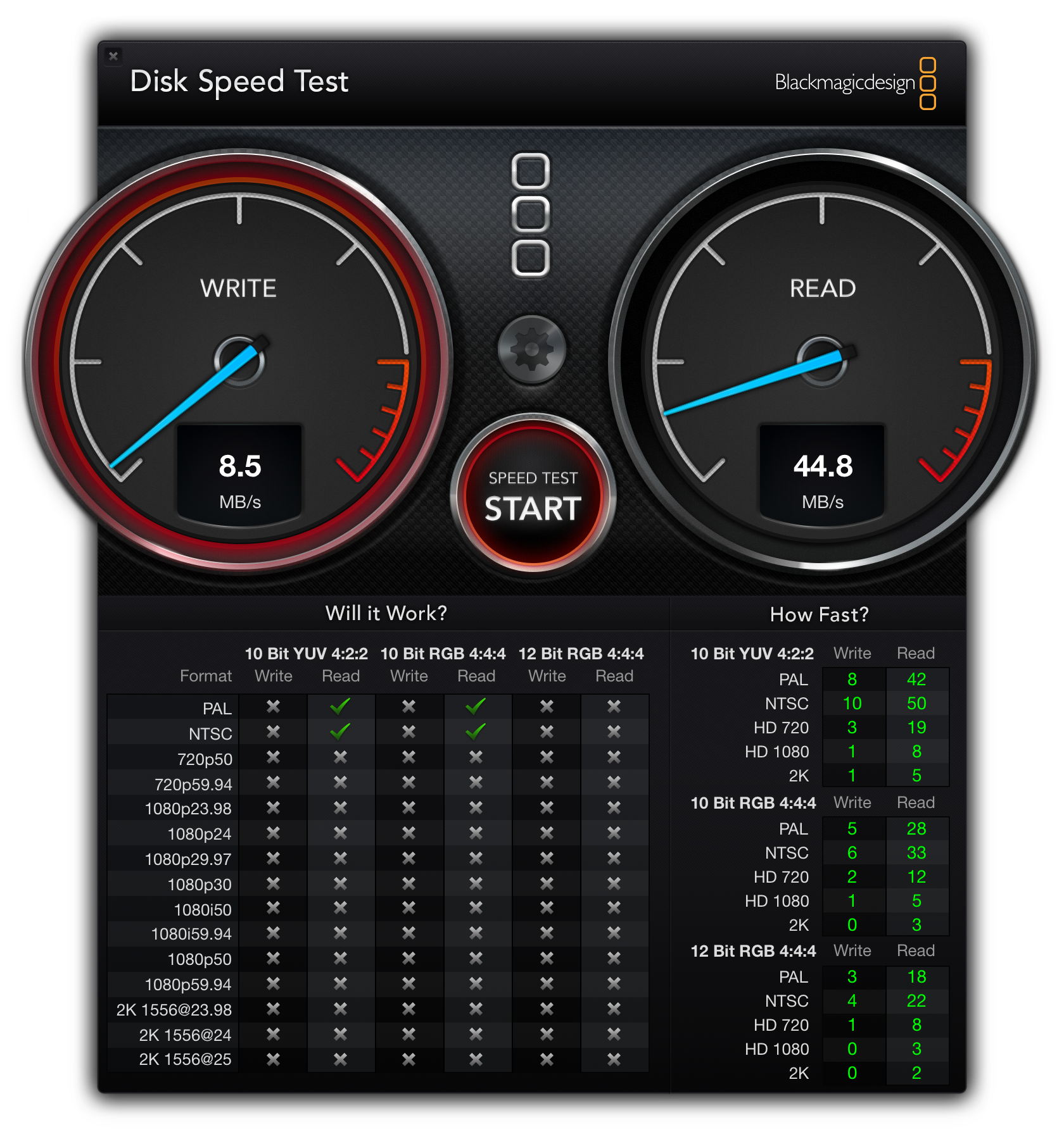

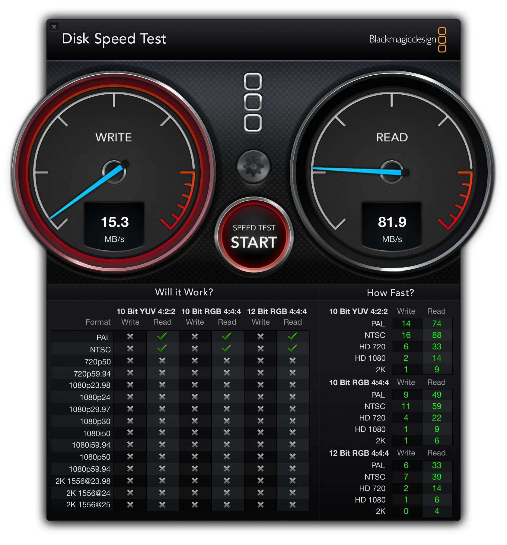

I'm not sure what's wrong with my cards, if anything, but here's my results with two Sandisk Ultra cards. 2014 imac 5k card reader.
The slower one is a Sandisk Ultra 16 GB 30 MB/s.
The faster one is a Sandisk Ultra 32 GB 80 MB/s.
Bothe are class 10 cards. They don't seem to be UHS cards.
Since write speed is the critical factor, not read speed, perhaps you should go for the Ultra Extreme--or better yet, consult published benchmarks.

For the bottom card, use a camera to do the format and then try again.
If a card's gotten too many file writes and rewrites over time, it appear slower because the file system might actually cause extra writes for the metadata.
Also, if you run a benchmark utility on a card, for best performance always format the card using a camera before putting it back into service since benchmark utilities will apply that sort of bad writing pattern for their random IO tests.

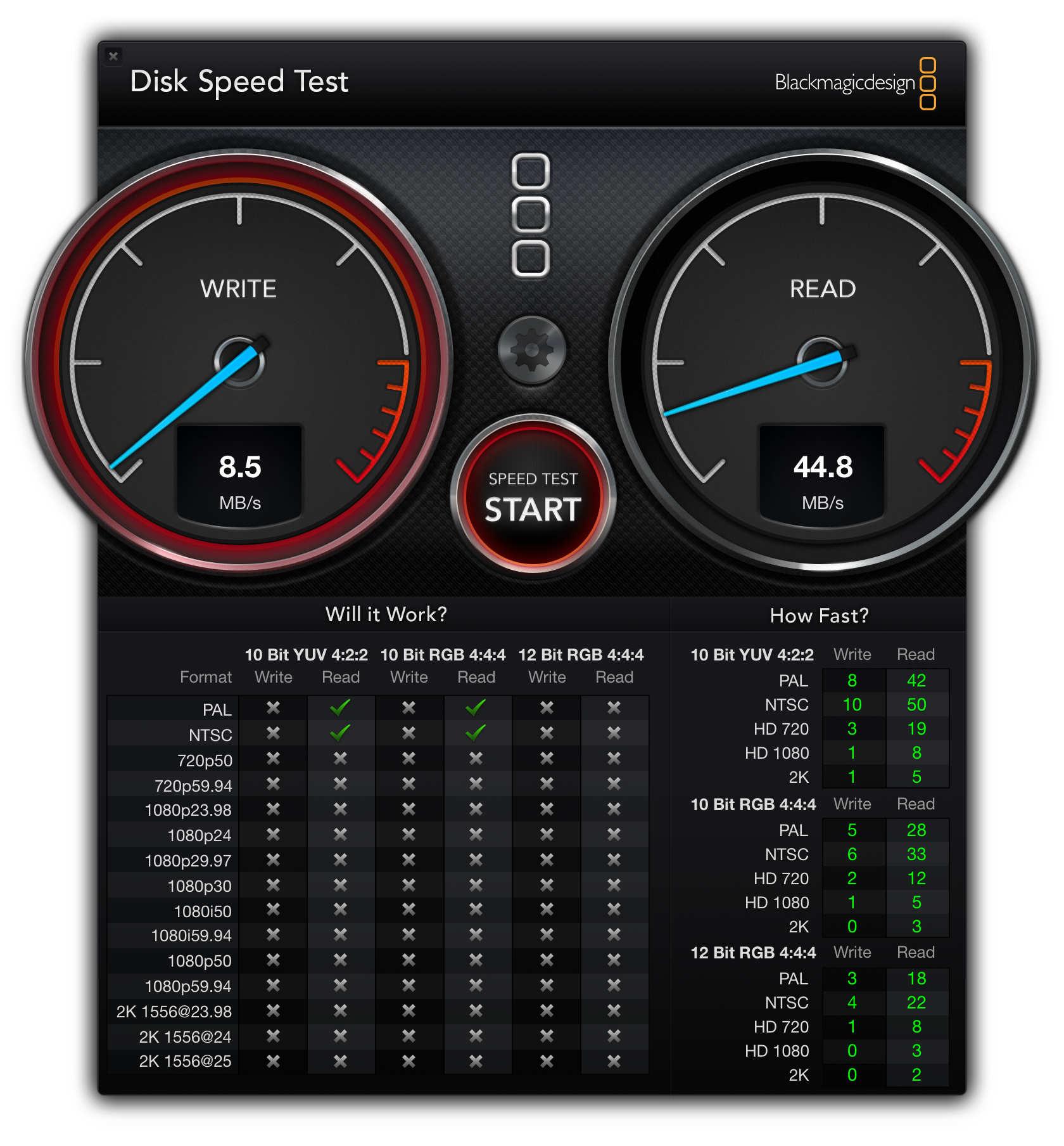

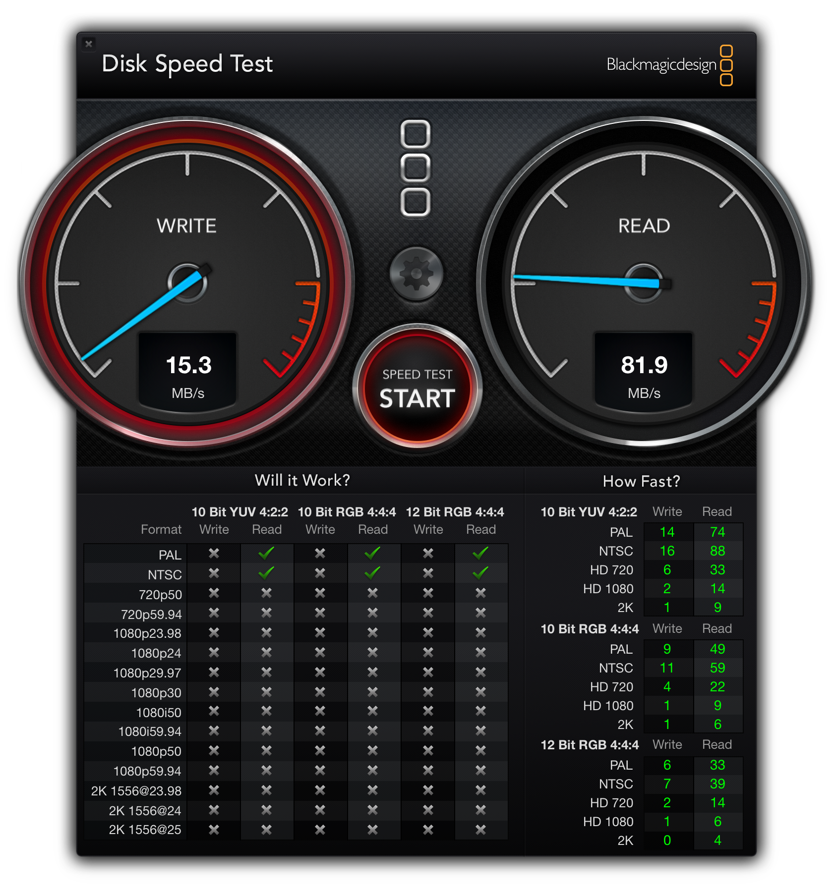

Since write speed is the critical factor, not read speed, perhaps you should go for the Ultra Extreme--or better yet, consult published benchmarks.View attachment 607372View attachment 607373
