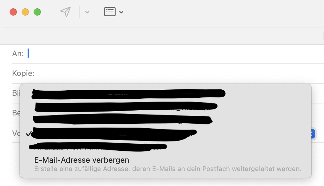

But that is not what it suggests... When I send a Mail I can choose my sender EMail. It also offers a HME Sender EMail. What use would that be if it then sends it via the primary Address?

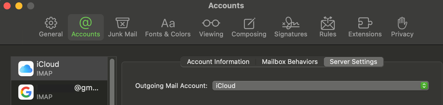

That is strange. My replies from the iCloud account used the iCloud smtp server. Perhaps you have something set incorrectly. When I select my iCloud account in Settings, I see that the "Outgoing Mail Account" is set to iCloud. I really don't know what would happen if I were to change that to one of the many other SMTP servers I've configured. Certainly google's SMTP server would not accept mail from a masked email address unless you went through a registration process for that specific email.

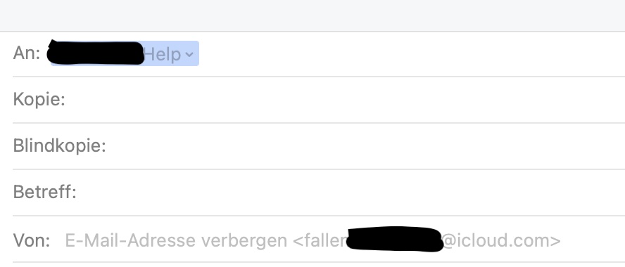

This is how the reply to window looked like, it was safe to assume it would use HME instead of the GMail account. Note the greyed out From: and To: fields. Only the Subject field can be edited.
