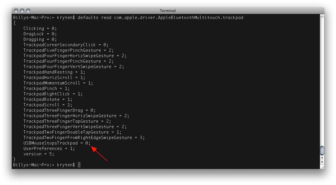

Perhaps this is what you're looking for?
No luck
I tried to use
Code:
defaults write com.apple.driver.AppleBluetoothMultitouch.trackpad USBMouseStopsTrackpad 1
and while it changes the value successfully, no effect.
And when the value is changed using the GUI's System preferences Accessiblity Mouse Ignore... the value in that plist does not change.
So that's not it, though it was a good suggestion.
