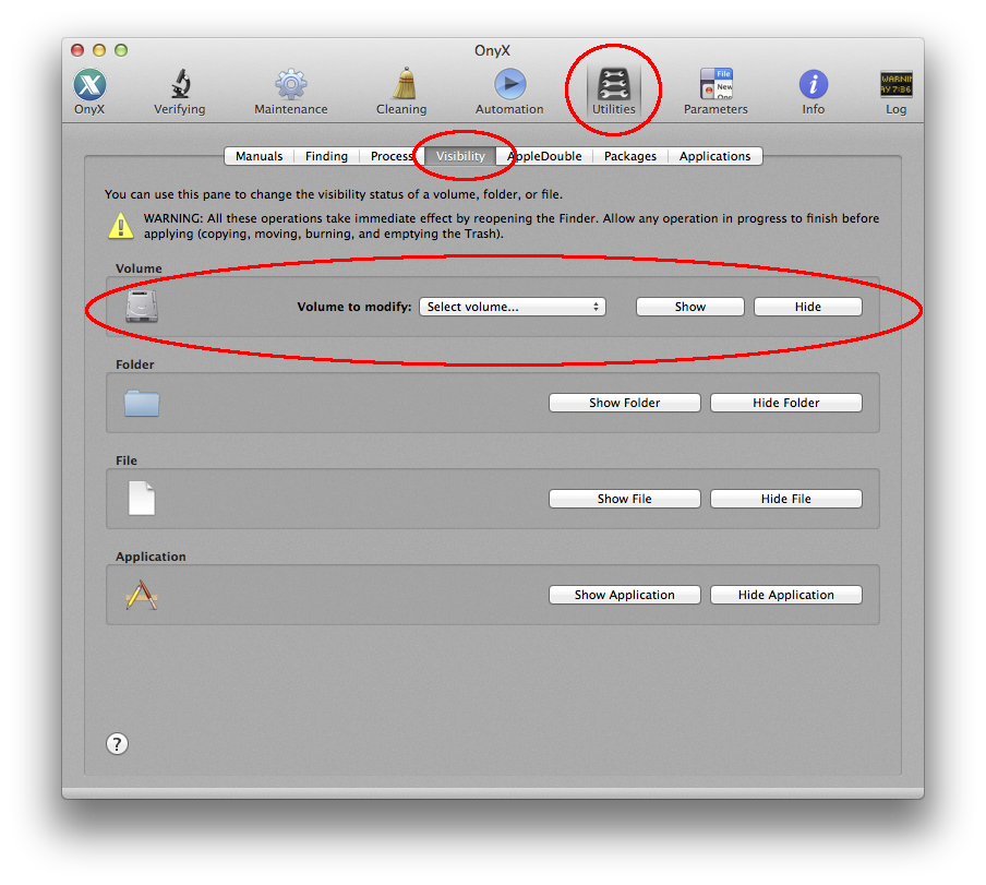

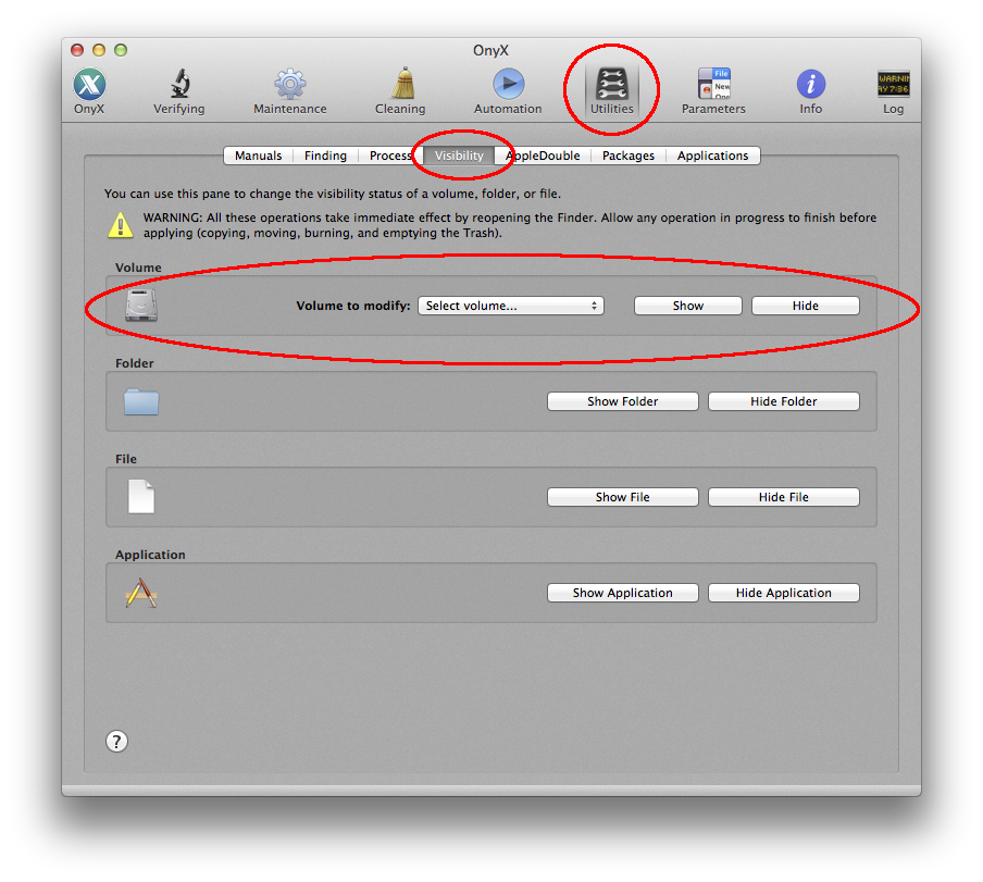

I'm not running Mavericks anymore but Yosemite...everything you're wanting to do can be done through preferences in Yosemite so it may be worth a quick check to see if this is the case in Mavericks too.
Which preference pane are you talking about? I can't find anything in Mavericks which allows you to change the visibility, but I have found out that Onyx allows for hiding drives (Utilities-Visibility). I'm going to try hiding drives this way instead of using the scripts and see if it solves my problems.

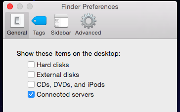

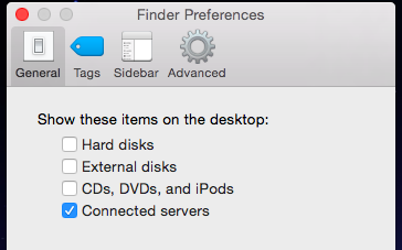

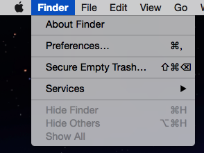

In Yosemite, the menu bar options for the Finder has a preferences section just for the Finder. Then, the first options are to show or hide different drives, etc. on the desktop. If you click on the sidebar option, you can choose what to show or hide in the sidebar of each Finder window as well.
Yes, this is a freature I've seen in every OSX version AFAIK, but it only allows you to show or hide ALL internal or ALL external drives, which is not what I want.
